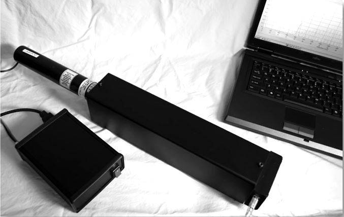

Hi, what is the cheapest double slit experiment setup or others where quantum state like qubits are isolated and can be experimented upon?
I saw the following in the net. It has a double slit inside the tube and the output is displayed on a monitor. I guess (not sure) it costs only $200. Has anyone seen this. What is it?
What others like it. Thanks.

You have not defined what you want to do very precisely. Consequently, nobody can tell us how much it will cost. You might think about explaining exactly what it is you want to do.
I just want to own a quantum device where the photon or particle is in superposition of entering the left and right slit. or perhaps there are commercial Stern-Gerlach devices too? Or perhaps there is already a common household object that can display such isolated superposition (of course all molecules and atoms have superposition but need a single particle isolated that can display it). Just want to have a lab with one quantum device for experiments.
Er... get a cheap glass slide, put it over a candle flame for a few seconds until you get soot covering all over it. Then get a sharp blade, and scribe two straight lines very close to each other on the slide that has the soot. Then get a cheap laser pointer, and voila! You have a double-slit setup!
I'd be surprise if this whole thing (including the laser pointer) costs more than $50.
Zz.

but isn't the laser pointer acting like a classical source of light.. or do you mean it can do one photon at a time that can interfere with itself?
Blue Scallop said:
but isn't the laser pointer acting like a classical source or light.. or do you mean it can do one photon at a time that can interfere with itself?
The interference pattern that you know and love is the result of single-photon interference. It doesn't matter if it comes from a single-photon source, or if it comes from a laser pointer.
Zz.

you mean a laser pointer emits single-photon at a time very fast.. what if one uses a powerfull small flashlight?
I guess a hole put in a sheet of paper with a needle + a laser pointer is also sufficient, and it gives a more interesting Bessel function as a refraction pattern :smile:. I once had a very cheap laser pointer, where they even delivered some gratings to play with. At the end it wasn't that cheap since it was pretty quickly not working anymore, but that's another topic...

No, a laser pointer emits coherent states. To make true single-photon states is not that easy. Even a very much dimmed laser doesn't procude single-photon Fock states but rather coherent states which are dominated by the vacuum state.
One way to make true single-photon states is to use a laser and a BBO crystal to create entangled photon pairs. Then you can use one of the photons in each pair to trigger for the other photon ("heralded photon source"). I'm not sure, how much such a setup costs nowadays.

You are going to be sadly disappointed when I tell you that IF your intention is to test out a "which-way" experiment using a single-slit setup, then you'll never accomplish it. It is not THAT easy especially when you have to now consider a photon detector.
Most, if not all, which-way experiments use an "interferometer" setup (look it up), not a photon "double slit" setup. This is a lot more elaborate because it requires more optical equipment than I think you are even aware of.
