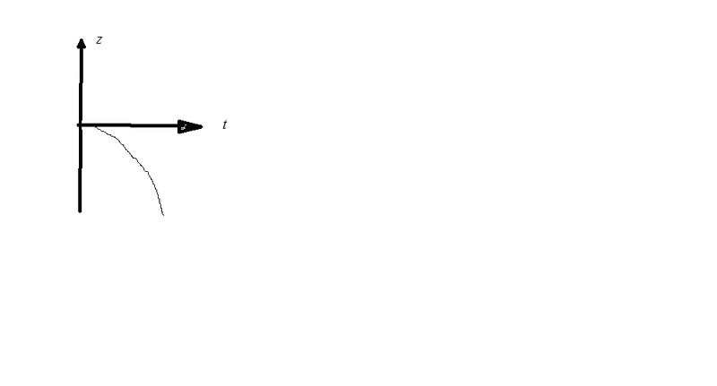

I am doing a problem involving a man dropping a ball from the top of a mast of a ship at [itex]t =0[/itex] a height [itex]h[/itex] above the origin of a ship's coordinate system.
In the sea's frame of reference, the ship is moving with velocity [itex]u\hat{i}[/itex]. The origins of these two frames coincide at [itex]t =0[/itex].
The question asks to calculate the position, velocity and acceleration vectors (of the ball)and sketch the position of the ball in both frames of reference, as a function of t.
So I got the position vector in the frame of the sea as [itex]\vec{h_s} = ut\hat{i} - \frac{1}{2}gt^2\hat{k},[/itex] and that in the frame of the ship as [itex]\vec{h_b} = -\frac{gt^2}{2}\hat{k}[/itex]. How do you go about sketching these as functions of t?
Many thanks
In the ship's frame, that's simple, you have only one dimension for position so together with time you can do a 2D diagram. In the sea's frame, however, you would have to do a 3D diagram. But I think you could still do that in 2D by eliminating time from the equation.
Thanks. I have very roughly sketched the position from the ship's frame in Paint (see attached). Regarding the position from the sea, what do you mean by eliminating t?
At t = 0. z = h. Not zero as sketched.
Regarding the ship's frame, observe that you have three coordinates: x, z and t. Both x and z depend on t. So you could express, for example, t as a function of x, then plug this into equation for z. Then you have z as a function of x. Which you can easily sketch on the xz plane, just like you sketched the motion in the ship's frame in the tz plane.

Eliminating t will give [itex]z = -\frac{g}{2u^2}x^2[/itex], which again is a parabola in the xz plane. When x = 0, the ball is at z = 0, so I should start the graph there this time?
The question asks for the graphs to be position as functions of time. Is there a way to do this for the sea's frame?
Thanks
In both cases z(0) = h. You forgot that constant in the equations.
Any sketch will be a planar projection. tx, tz and xz are easiest. You could do a dimetric projection but that requires some skill.

Well, not exactly. x = ut, so there is a scaling factor AND the units of t and x are arbitrary. So you can make it exactly the same, or you can stretch it in any cardinal direction.
How does it arise when we eliminate t to get [itex]z = -\frac{g}{2u^2}x^2?[/itex]
If you read the problem carefully, you will note "at t=0 a height h above the origin of a ship's coordinate system". So that means your very first equation should be ## \vec{h}_b = (h - \frac {gt^2}{2}) \vec{k} ##. Hence, ## z = h - {gt^2}{2} ## in either frame.
What I should really have is;
[itex]\vec{h_b} = (h-\frac{gt^2}{2})\hat{k}[/itex] for ship's frame and [itex]\vec{h_s} = ut\hat{i} + (h - \frac{gt^2}{2})\hat{k}[/itex] for sea's frame. Thanks for correcting me.
