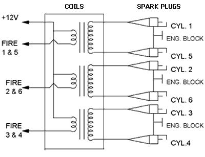

My 02 jetta misfires on cylinder 3 when it rains, has anyone ever had this problem and do I fix it? Also my horn doesn't work when it rains, I don't know if its related but it seems to odd to me coincidence. Thanks for help.

These days the electric system is really touchy. When we ran into this situation the first thing to do is run a ground wire from the negative side of the battery to the engine. Try grounding it a the 4 coil ignition pack. I suspect you have a coil pack going out on you as the #3 coil is sandwiched between two other hot coils. Maybe has had oil leak. Check for this oil around the body of the coil pack. Run another ground wire to the body. Years of body flex and vibration will cause loss of ground. If this does not cure things go for the in depth. I would check the wire connection at the horn as this is at the front of the car where all the slush and road muck rally corrodes things. Again a bad ground. Electrical resistance gores up when things are wet.
One thing I have always found helpful when diagnosing wet weather symptoms is a cheap spray bottle full of water. With the car at operating temperature I would spray around each component (coil, plug wires, etc.). Do these issues start at the same time?
Run it in the evening with hood up. Look for tiny sparks jumping around #3 sparkplug and its wire.
But I'm more suspect of the coil pack - they will develop cracks that allow moisture ingress.
If you can see the coil, look for a small black line on it where case has split.
If it's the coil it will get worse,
and if it's a setup where one coil serves two cylinders(which i think it is) you'll get misfire codes on that cylinder too.
Try a search on "2002 VW coil pack recall"

See if your misfire codes are on two cylinders served by same coil.
Reason i think that is i just helped a neighbor with his 4 cyl Chevy that uses similar coil pack. We found a split on the side of mis-behaving coil that served #1 and #3, the two that reported misfires.
On the GM coil pack an ohmmeter between the two high voltage leads for a good coil shows a few thousand ohms, and no connection to ground( the metal frame..) Bad coil showed a few thousand to ground. Yours might be similar.
Yes your right it is a coil pack, you are almost certainly right that it is a crack in the housing but sadly it is very hard to see it as in is tucked under and behind the air intake. Is there a risk in using a spray bottle to check for shorts? I can't imagine that its good for the car to cause a short on purpose.

Resistance readings from my friend's spark plug connectors would have told us what was wrong had i known how to interpret them. I described that above.
Maybe z51vette knows -
if your VW pack is is like this
you should read several thousand ohms between the two plugs served by one coil
and no continuity at all from any plug to chassis ground.
A plug wire itself should read a few thousand ohms. So use a high ohms scale at least RX1k and X10k would be better.
Plug wires themselves can fail open circuit but that'd probably just kill the cylinder entirely. Two to ten thousand ohms per foot is ballpark for them.
I'm not 100% sure which engines they used waste spark on. However, I believe the 2.0l isn't waste spark, but i could be wrong. It might be worth looking on the VW forums, I'm sure there are experts on there.
As for testing coils the primary side is generally low(less than an ohm) the secondary side shall will be higher (several thousand ohms). Even if it test good, it could still be breaking down with moisture.
