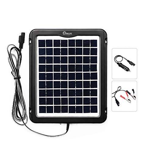

a one foot square photocell right under the bulb would provide some trickle current when the light is on.
one can buy solar trickle chargers.
They won't give full output in artificial light, but just asking might help 'break the ice" with landlord.
Or if located next to a window...

Btw, this morning I did an analysis on a pair of solar panels I bought for my friend's boat.
Her batteries seldom lasted more than a year. (4 months of boating, and 8 months of sitting)
I think a 5 watt solar panel is the perfect solution to extend a seldom used battery's life.
The only problem I can imagine is remembering to unplug it before you drive away.

I cannot use a trickle charger. The reason is this: The garage where we keep the car is not owned by us. It has been taken on rent (don't know about the USA, but this is something quite common here). As per the legal agreements, we have access to a light connection only, and not a plug point.
Although it doesn't take much to draw a socket from the bulb connection, the owner periodically checks, and alterations, whatsoever, are banned by the agreement.[/USER]
Two ideas:
1) Talk to the landlord and offer to replace the energy consuming inefficient filament bulb with an energy efficient LED bulb if he will let you add a tiny little trickle charger that uses almost zero electricity.
2) Offer to pay the landlord for the electricity used by a trickle charger at two or three times the rate that he pays. You can measure the electricity with a Kill A Watt or similar:
[/user]
I trust they're set up for the country where you buy them. Mine is 120VAC and has that NEMA 5-15 receptacle as in the photo.
And mount the solar panel on the outside of the garage.
