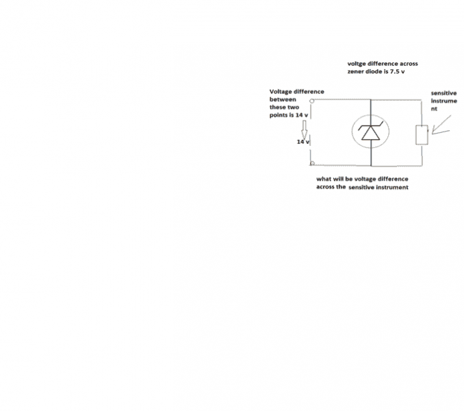

:What will be potential difference across the sensitive instrument?[/B]
[/B]
:I think the potential difference across the sensitive instrument would be 7.5v.[/B]
Is the diagram correct and complete? It shows that all the components are connected in parallel, yet states that the potential difference across the zener diode differs from that of the supply voltage. That's not how parallel components behave.

They are taking certain liberties with circuit theory, omitting complicating details in order present a concept. In the context of way the material is presented your answer is fine.

The major omission is a resistance between the source voltage and the zener that would host the potential drop between them.

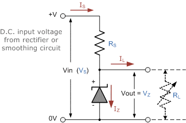

The load is connected in parallel with the zener diode, so the voltage across RL is always the same as the zener voltage,how connecting resistance in series and parallel differs?
In my textbook it is written
With no load connected to the circuit, the load current will be zero, ( IL = 0 ), and all the circuit current passes through the zener diode which in turn dissipates its maximum power. Also a small value of the series resistor RS will result in a greater diode current which in turn dissipates its maximum power.That's why we connect load and greater value of RS so that it's power is not dissipated.But Why we want to save zener power?
I think it is because greater current(greater than max current of zener will cause it to damage.Right?

It does. But that drop is the same as that across the zener (they are in parallel). It is the desired operating condition of the load.
The resistor Rs in your diagram is in series with the zener//load combination. Its voltage drop depends upon the current through it. The current through it is Is in the diagram, and is comprised of Iz + IL.
Yes, to protect the components you want to remain within their safe operating parameters. It is also good engineering practice not to waste power unnecessarily. Batteries are expensive. :smile:

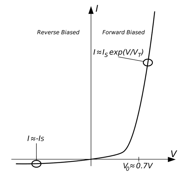

Can you please explain how zener maintain constant voltage?I have gone through many sites but no one explains this.
The video you linked to showed the I-V characteristic curve of the zener. It is the heart of the explanation. The voltage across the zener simply cannot go (much) beyond its reverse breakdown voltage. At and past the breakdown voltage very tiny increases in voltage lead to relatively massive increases in the current through the device. That increased current passes through the Rs of your previous diagram and causes a potential drop there. So the voltage across the zener remains steady and the "excess" voltage is dropped across Rs.

The resistor Rs is in place to moderate such currents when the source voltage rises. Remember I said that Rs and the zener resistance form a voltage divider that greatly reduces the magnitude of the voltage change that appears across the zener compared to a change in the source voltage.

Not quite. If Iload*Rs drops the voltage below the zener voltage then the zener is cut off (stops conducting) and effectively disappears from the circuit. The load voltage becomes unregulated at that point.
Vsource being equal to Vzener is not practical as there will be some voltage drop across Rs due to the load drawing current through it, even if the zener is cut off. Again the zener would be ineffective as a regulator.
A correct operating point for the zener is to maintain a current through it that exceeds its "knee" current by a comfortable margin when the source voltage is at its lowest anticipated value and the load drawing its maximum current. This is why you'll often see source voltages specified as a nominal value with a +/- percentage associated with it. It tells you the minimum and maximum values to expect during operation.
