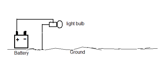

When I connected the positive terminal of the battery to one terminal of the bulb and the other terminal (of the bulb)to the ground the bulb did not glow, even when a potential difference exists?
I don't know what actual circuit you were using but the - on your battery needs to have a continuous connection to Earth. The Earth has to complete the circuit. Check the connections. (Try it with just a negative' wire first, to check battery, bulb and holder.)

No this is not my circuit , the negative side of the bulb is connected to the ground instead of the negative terminal of the battery

If you don't connect bulb and battery to Earth then how is there a complete circuit`??
Left to its own devices, the positive terminal of the battery will be pulled to Earth potential and the negative terminal will find itself at -battery volts.
There is no potential difference across the bulb. Why should the bulb care if there is a potential difference somewhere else?

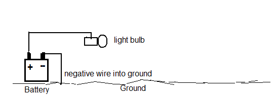

This ... ?
If not that, where does the negative terminal of the battery go to then ?
You may now realize how unclear your original description wasDave

Everyone with a question about circuits should do us the courtesy of giving some sort of a labelled diagram.
There is no potential difference across the bulb. You appear to be assuming that the -ve terminal of the battery is at 0V with respect to ground. That's a mistake.
Lets say it's a 9v battery. The +ve terminal is connected to ground via the bulb. The -ve terminal of the battery is not connected to anything so it will be at roughly -9V (minus nine volts) with respect to ground. This is because the resistance of the bulb is much lower than the resistance of the open circuit on the -ve terminal.
Perhaps consider a 9V battery still isolated in it's packaging. The -ve terminal is not necessarily at 0V with respect to ground. All you can really say is that the +ve terminal is +9V with respect to the -ve terminal. You can't be sure the +ve terminal is 9V with respect to ground until the -ve terminal is connected to ground.
