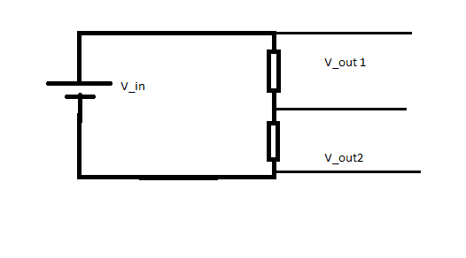

This is how my teacher drew the potential divider.
And told that the energy lost by the resistor is equal to the energy given to the components on the branch.
Or the voltage of the resistor is equal to the voltage given to the components in the branch.
How does the energy of the resistor go to the components??I thought energy is lost as heat.

hi adjacent! :smile:
yes :smile:
i suspect your teacher was talking about the potential energy (ie energy per charge) …
voltage drop is the same as loss in potential energy
so let's rewrite …
… my teacher … told that the energy lost by the resistor is equal to the energy given to the components on the branch.
as:
the potential energy lost (the voltage drop) across the resistor is equal to the potential energy lost across the components on the branch.
Or the voltage drop across the resistor is equal to the voltage drop across the components in the branch. :wink:
(i don't like this "lost" versus "given" terminology …
potential energy doesn't work like that :redface:)
Oh,I used my own terms.Thanks for the correction.
But I still don't know why voltage drop across the resistor is equal to the voltage drop across the components in the branch.
How is the energy transferred?Resistors normally waste it as heat.Am I wrong?

forget energy!
this has (almost) nothing to do with energy
this is about energy per charge
the charge going through the resistor each second (ie the amps) is much less than the charge going through the components
so the energy going through the resistor each second is much less than the energy going through the componentsit is only the energy per charge that is the same
(i suspect you are missing the point that a general principle of voltage, or electric potential, is that it is always the same between any two points, in this case through the resistor and through the components …
ie, the same charge would do the same work going along either route)
btw, energy ~ V2/R, so it pays (literally!) to have the resistor R as large as possible, to keep the energy loss very small
tiny-tim.I know that.Sorry I wrote energy.
Why do we use a resistor there?To divide the voltages between two branches.So the voltage drop of the resistor is equal to the voltage drop of the components in the branch.
I understand this,but how?My main concern is resistors waste energy.
(Forgive me.Try to think in my perspective about resistors wasting "energy")
aaaaa.I have made myself more confused. :confused: :confused: :confused:
yes, they do waste energy, you can't avoid it
if you have a 240 V source, and your components will only take 120 V, you can use two equal resistors R in series, with the components parallel to resistor (and nothing parallel to the other resistor) …
then all the current will go through the second resistor and waste a lot of energy if R is large, but if R is small too much current will go through the first resistor and waste a lot of energy, so you can't win :redface:

The word 'waste' is a bit of a value judgement. Resistors transfer electrical power to Heat. That may be desired or not, according to the circumstances.
The function of a resistor in a circuit is usually to cause a current of a specific value to flow or, in association with some other component (resistor, Capacitor, Transistor, Inductor), to produce a desired voltage somewhere. Resistors are the foot soldiers of circuit design; well behaved and robust.
Your example of a Potential Divider is a very common circuit element.
This link more or less says all you need to know about the how it works. Choosing what actual values to use to do a particular job (as well as their relative values) needs a bit of care or you can (literally) "waste" some power, when they're lower valued than necessary or don't do their job because they cannot supply enough current to maintain the wanted voltage.
The problem when you are taught this stuff for the first time, you tend not to see any reason for it. IF it were possible to deliver electronics along with a project, then you would want to achieve things and those boring laws and formulae would actually appear to be much more worth while because they would actually help you. There's a 'critical mass' of experience needed before Electronics starts to have enough context for beginners. Jusgt stick with it and you will find it comes, eventually.

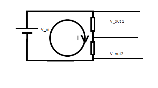

Perhaps it is easier if you consider the current flowing as well... Let's say the current flowing is I. Then...
The power delivered by the battery is:
P_in = V_in * I
The power dissipated/wasted in each resistor is:
P_r1 = V_out1 * I
P_r2 = V_out2 * I
The law of conservation of energy means that the power dissipated in the resistors must equal that delivered by the battery. I think this is what you mean by...
... the energy lost by the resistor is equal to the energy given to the components on the branch.
So...
P_in = P_r1 + P_r2
Substituting..
V_in * I = (V_out1 * I) + (V_out2 * I)
I cancels so...
V_in = V_out1 + V_out2
Your last question is..
It is lost as heat.
In this circuit the power dissipated in the resistors is equal to that delivered by the battery. This is because there is nothing connected to V_out1 or 2.
