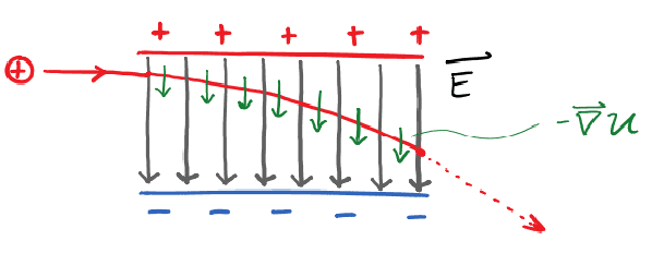

consider a charged ideal parallel plate capacitor:
(where the fields do not leak outside the plate area)
positive test particle enters orthogonally to the field. but because the acting force on the particle is orthogonal to its motion, the effective potential energy for determining bound vs scattering state, is zero.
but at the end, the particle has a velocity component parallel to the force, so it has a chance to be bound or scattered along this vertical axis.
is this correct?

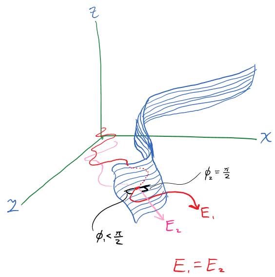

no this is purely for my own conceptual understandingultimately what i wanted to get around asking was imagine a potential barrier in R3.
the red and pink represent the paths of two separate charge particles (sorry i didn't mean to draw them as if they were actually crossing one another. the focus is supposed to be between the barrier and each particle considered separately).
each particle has the same kinetic energy. but see how one particle is incident to the barrier at an angle and the other particle is incident at a right angle?
i just wanted to ask if the transmission/ reflection coefficients are solely determined by the kinetic energy component that is orthogonal to the barrier.
