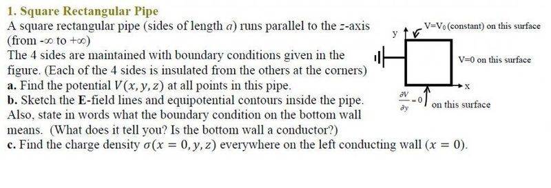

Homework problem statement on a square rectangular pipe: a diagram of a square cross-section with V=V0 (constant) on the top wall, V=0 on the right wall, and dV/dy = 0 on the bottom wall, with the left wall marked as grounded; parts a, b and c are listed below it.

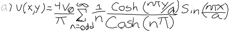

Is my part a correct and am I on the right track for part b? If not please give me some suggestions to get me closer to the right track. Also, how would I even begin c.? We have literally done no examples like this in class.
Solution to a.)
Handwritten solution: V(x,y) = (4V0/π) sum over odd n from 1 to infinity of (1/n) times cosh(nπy/a) / cosh(nπ) times sin(nπx/a).
For b. I simply took -(del) on it. But I have no idea how to graph my solution. Is there a better way to approach this?
