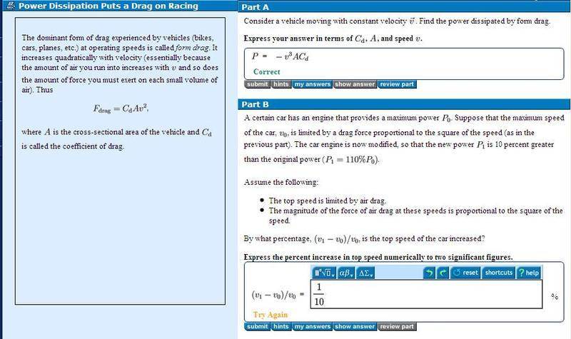

P=F*V
why isn't it
P = Cd(A^2)(v^2) * (v)
i don't see what i could do

soupastupid said:
P=F*V
This is correct.
why isn't it
But this is not. You made an error when you substituted for F in the power equation. Redo it, paying attention to each factor in the drag formula.

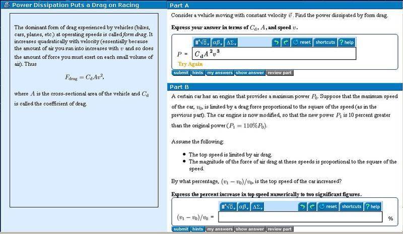

ok i figured out the first part
how do i figure out part B?
I kno the power is proportional to v^3
and so if i increase the power by 10%
i should get
if Pi = -(vi^3)AC_d
then 1.1Pi=-(vf^3)AC_d
Pi = (-(vf^3)AC_d ) / 1.1
(vf^3) = 1.1(vi^3)
then what?

Solve for Vf in terms of Vi. (Take the cube root of both sides.)
