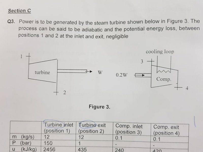

Shown in the figure
W= (p2v2-p1v1) / (1-n)
I am not sure where to start and where to use all the data given in the table. Please help.

Thanks for moving your question. I copy-paste my answer from the original post:
You need the first law of thermodynamics for open systems, since mass enters/leaves the turbine it is not a closed system. The law reads
$$\delta Q +\delta W + \sum \left[\dot{m}_i \left(e_i+h_i \right) \right] = \Delta U + \Delta E $$,

Start with question a) (and forget about the compressor at first). Now you define the system turbine by mentally putting it in a "box" called system. Now you only observe what is entering and exiting this system, which is described by the left-hand side (LHS) of the above equation. So ask yourself:
1) Is heat (##\delta Q##) entering or exiting the system?
2) Is work (##\delta W##) entering or exiting the system?
3) Are mass flow rates (##\dot{m}_i##) entering or exiting the system?
The right-hand side (RHS) of the formula describes the change of the energy in the system. So assuming steady state operation:
4) Does the energy content (##\Delta U + \Delta E##) of the system changes with time?

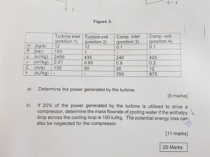

Below are my calculations, please check if they are correct.
h(out) = u +pv = 435 kJ/kg + 1 bar x 0.65 m^3/kg = 500 x 10^3 m^2 s^-2
h(in) = u + pv = 2456 kJ/kg + 150 bar x 0.01 m^3/kg = 585 x 10^3 m^2 s^-2
Thus, dW = m( h(out) - h(in)) = 12 kg/s x (-85 x 10^3 m^2 s^-2)

For ##h_{out}## I obtain the same result, even if at the left-hand side your units are not consistent:
$$h_{out}=u + pv = 435 \cdot 10^3\;J/kg + 1\cdot 10^5 \; N/m^2 \; 0.65\;m^3/kg = 500 \cdot 10^3\;J/kg = 500 \;kJ/kg$$
For ##h_{in}## I obtain a different value, but unfortunately I can't reproduce your result even with the formula you've written down. I suggest that if you write down equations like that to use the correct units in each term, otherwise one makes mistakes.
However, as I mentioned in my last post, if the kinetic energy should be considered, then
$$h_{out}=u + pv = 435 \cdot 10^3\;J/kg + 1\cdot 10^5 \; N/m^2 \; 0.65\;m^3/kg + \frac{50^2}{2}\; m^2/s^2= 501250 \;J/kg = 501.25 \;kJ/kg$$
My calculation was wrong. I understand how you calculated the kinetic energy part, using the velocity.
h(in) = u + pv = 2456 x 10^3+ 150 x 10^5 x 0.01 m^3/kg = 2606 x 10^3 = 2606 kJ/kg
Then, h(out) - h(in) = 501.25 - 2606 = -2104.75 which is a negative value.
Substituting the value into the equation,
dW = m(h(out)-h(in)) = 12 kg/s x (-2104.75 kJ/kg) = -25257 kJ/s which is the power generated by the turbine.
Am I correct?

The method is correct, but you calculated the enthalpy ##h_{in}## without the kinetic energy - it should be slightly higher, when taking into account the kinetic energy with a fluid velocity of 130 m/s. It's up to you whether you neglect the kinetic energy or not, but it should be the same for the inlet and the outlet.
I get what you mean, thanks. So h(in) would be 2456 x 10^3+ 150 x 10^5 x 0.01 m^3/kg + 130^2 / 2 m^2 s^-2 = 2614450 kJ/kg.
h(out) - h(in) = 501.25 - 2614.45 = -2113.2 and dW (P) = 12 kg/s x (-2113.2 kJ/kg) = -25358.4 kJ/s.
For question (b), I first calculated 20% of the power generated by the turbine.
Then, -25358.4 x 0.2 =-5071.68 kJ/s .
As dW (P) = m(h(out) - h(in)) and the enthalpy drop across the cooling loop is 100 kJ/kg,
-5071.68 kJ/s = m(875+ 0.5 x 12^2 - 350 - 0.5x20^2 -100) to get the mass flow rate of cooling water.
Am I on the right track?

Here you mixed up the enthalpies of the compressed gas and of the cooling water, additionally your units are not consistent (you take the enthalpies into account in kJ/kg and the kinetic energy in J/kg).
How should I consider the cooling loop? Should I also take the work coming inwards (0.2 W) into account?
Let's start from the beginning:
1) adiabatic ##\rightarrow \delta Q = 0##
2) work ##\rightarrow \delta W = P_{Comp} = 5.072 \; MW## (which has a positive sign now, since it enters the compressor)

The 1st law reads:
$$0 + P_{Comp} + \dot{m}_g \left[ \left(h_{g\;in} + e_{g\;in} \right) -\left( h_{g\;out} + e_{g\;out} \right)\right] +\dot{m}_w \left( h_{w\;in} - h_{w\;out} \right) =0$$
Since the density change of water is negligible, the velocity is constant, so no change in the external energy (##e_{w\;in} - e_{w\;out}=0##).
Except the mass flow rate of the cooling water, everything is known.

0 + 5.072x 10^6 + 0.1[(350x10^3 + 0.5x20^2)-(875 x10^3 + 0.5x12^2)] + m(water) (-100 x 10^3) = 0
m(water) = 50 kg/s
I double checked, please let me know if my answer is correct.

At least I have the same result ##\dot{m}_w \approx 50\;kg/s## - seems to be a very bad compressor or I've overlooked something. But in general that's how you could solve this kind of problems. Have a nice Sunday!
