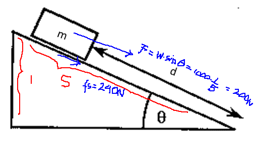

1) A packing case weighing 1000N is loaded onto the back of a lorry by being dragged up an incline of 1 in 5 at a steady speed of 2m/s. the frictional resistance to motion is 240N, Calculate:
a. The power required to overcome friction
b. The power needed to overcome gravity
c. The total power needed
The problem I have is i don't know what i need to do to the incline.
Please could someone guide me

Work is defined as the product of force and the displacement in the direction of the force. For gravity that would be the vertical displacement. Think about the consequences for power.

As it goes up the slope it's height and therefore it's PE is changing. Power is the rate of change of energy.

in my mind, incline of 1 in 5 as figured bellow
a. answered.. [itex]P_{friction}=480 joule/s = 480[/itex]watt
b. to overcome gravity
[itex]P_{g}=mg.sin θ v= 1000 \frac {1} {5} 2[/itex]watt
c. [itex]P_{total}=480+200=680[/itex]watt
1. The protocol on these homework fora is to nudge people in the right direction, not write out complete solutions.
2. Check your arithmetic.
