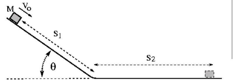

Trouble on this final problem of my physics homework
M g h + 1/2 mv^2 - (s1+s2)umg=0
h= 1.18sin(28.1) = .55579
When mass M is at the position shown, it is sliding down the inclined part of a slide at a speed of 2.19 m/s. The mass stops a distance S2 = 2.1 m along the level part of the slide. The distance S1 = 1.18 m and the angle θ = 28.10°. Calculate the coefficient of kinetic friction for the mass on the surface.
https://letu.loncapa.net/res/msu/physicslib/msuphysicslib/13_EnergyConservation/graphics/prob27a_MechEnWFriction.gif

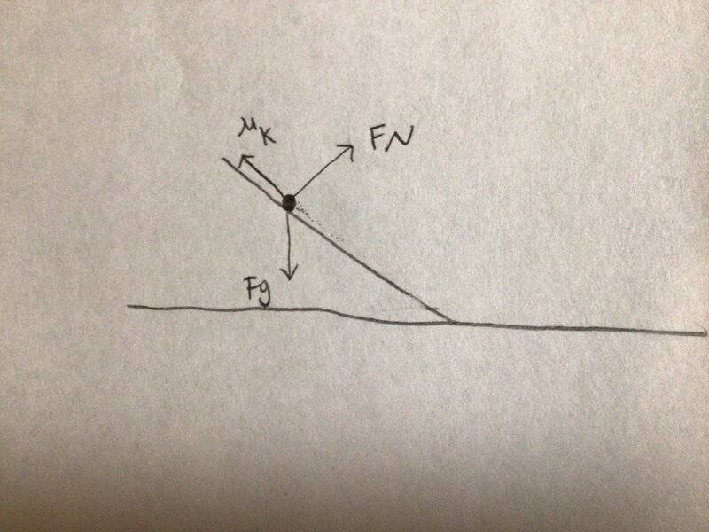

Good. So what can you say about a value of kinetic friction on a ramp that allows constant velocity down the ramp?
What two forces are equal in that situation? Can you post a Free Body Diagram (FBD) of the mass while it is sliding down the ramp?

The above equation looks like it is a correct application of the work energy theorem, however it is wrong. What is wrong is that the total work of friction is not ##(s_1+s_2)umg## because the normal force is not equal to ##mg## for the whole distance. It is equal to ##mg## only during the s2 distance.
Also we don't know if the friction coefficient is the same and equal to ##u## for the whole distance, we have to assume that otherwise it is not solvable by the data given.
