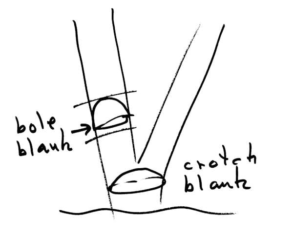

If the crotch is solid, that's a good place to get a bowl blank that will have some figure for sure but if the crotch is weak then a bole section is best. I'd do both just in case unless the crotch is deeply cracked in which case I'd just do 2 bole blanks.
Hand-drawn sketch of a forked tree trunk above a wavy ground line, with two curved outlines marking a bole blank section on the left trunk and a crotch blank at the fork, labelled "bole blank" and "crotch blank".

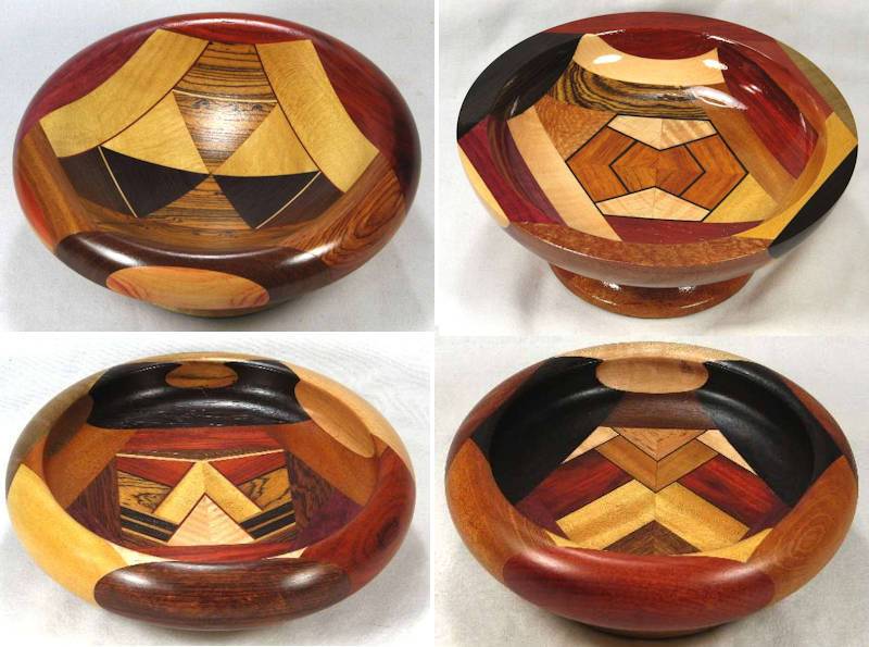

As for the bowls I really only do laminated ones. On very rare occasions I've done solid wood bowls but I don't prefer it. I thank you for the offer though.
phinds said:
Why do some people collect matchbook covers? I'm a woodworker. I work with exotics and am interested in them.
Four photos of wooden bowls with inlaid geometric patterns in contrasting woods, showing red, golden, dark and striped grain, seen from different angles.

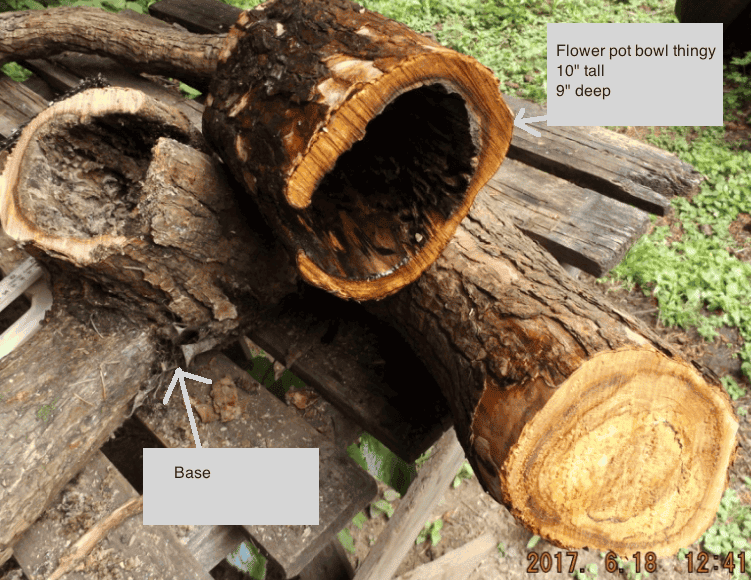

Well, I have some good news and bad news. The good news is, after I chainsawed the lower crotch off, I found that ants had been busy turning the stump into a bowl for me. I chopped off another 10 inches, and missed the end of their work by 1 inch. So now I have a really tall bowl, or maybe a flower pot.
The bad news was, that I didn't have to buy a lathe after all, as they did 90% of of the work for me.
The good news is, that I'll probably pick up a lathe anyways, (I've always wanted one.) as this wood is REALLY hard, and I've been planning on making a wood capstan for my boat.

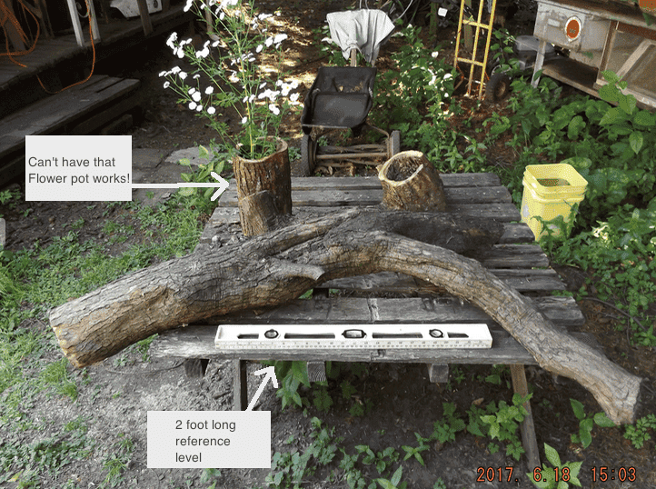

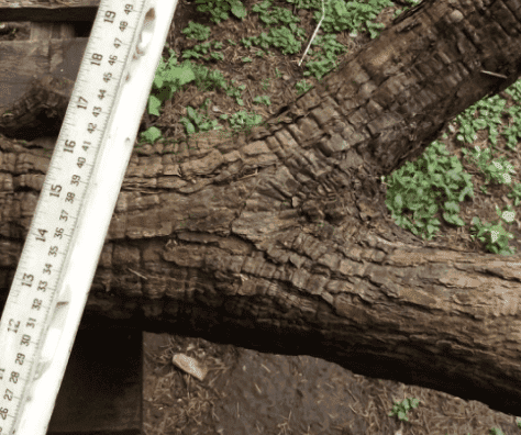

Here are a couple of images:
Photo of a cherry tree branch laid across a weathered wooden table outdoors, with a white two foot reference level lying on the table beside it, two wood stump pots and white flowers on top, dated 2017.
Photo of a weathered cherry log section with rough bark, resting on an old wooden pallet table outdoors; a spirit level lies across the pallet, and a text callout notes the base is filled with dirt, rotten wood and mildew.
Any recommendations on "sterilizing" the wood? It's full of lots of live things. I was thinking of putting it in the oven at 200°F for about 12 hours. Not sure if that will kill the 3000 types of fungi/slime molds/ants/wood beetles/pill bugs/spiders/ET AL! I've seen that have infested it.
(It's rained here 300 out of the last 200 days...)

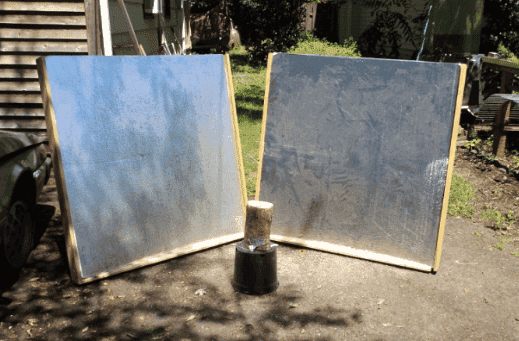

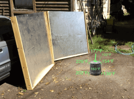

After about 2 hours of research, I decided to build a makeshift kiln dryer.
Kiln drying wood
The temperatures employed in kiln drying typically kill all the fungi and insects in the wood if a maximum dry-bulb temperature of above 60 °C [140°F] is used for the drying schedule. ​
I think I'll repurpose the solar thermal collector materials my sister talked me into buying. She's flying into visit in two days, and I'm certain she'll complain that I never finished that project.
If that doesn't work, I'll throw it in the microwave.
9 am, and the surface temperature is already up to 160°F!
[edit: 199°F @ 9:20 am :bugeye:
hopefully, I don't burn down the neighborhood.
Internal wood temperature: 76.5°F
Probably residual from when I drilled the hole.
ps. I cut the log to 10", so I could monitor internal temps.
pps. The residual "legged" bugs are not happy. :oldcry:]
[edit #2: 221°F @ 9:40 am :oldsurprised:
core wood temperature: 91.7°F
did not check to see if there were any stubborn bugs
fascinating varying positional surface temperatures of the oven
It's almost, like, science, works.]

Cool kiln.
Thanks!
Final core temperature was 141°F.
And just in the nick of time, as my trees have decided it's time to turn off the kiln.
You really have to plan ahead when solar powered.
(I still can't believe I had everything set up by 9 am this morning.)

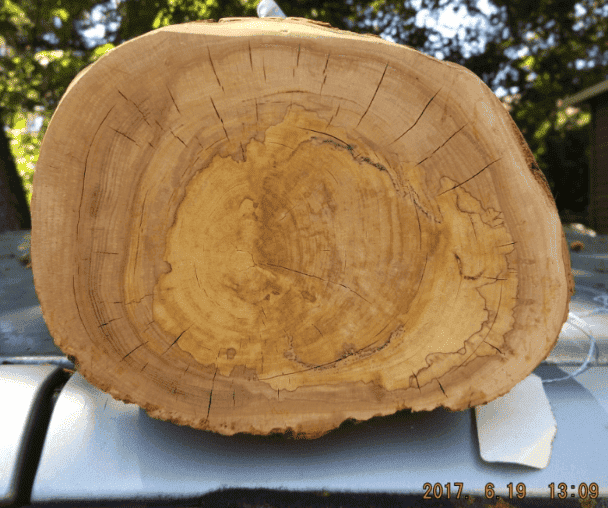

Two large solar panels with wooden frames stand angled on a driveway in sunlight, flanking a wooden log standing on a black stand.
Uh oh. What was that term I heard yesterday? "Checking"? aka "CRACKS!" :oldcry:
Cross-section of a cut log lying on a car roof, showing concentric growth rings and radial cracks radiating from the centre, with a timestamp reading 2017. 6 19 13:09 in the lower right.
Again, in my defense, this is my first try.
Do you still want this? I have two more segments of this length and size. As I mentioned earlier, I thought of at least 6 ways to kill the bugs, 3 of which might also kill me. A seventh option would be to just quadruple bag a log, and let you worry about the bugs.
ps. Maybe if I stick it in the freezer, the "checks" will "cold weld" themselves back together. :oldeyes:

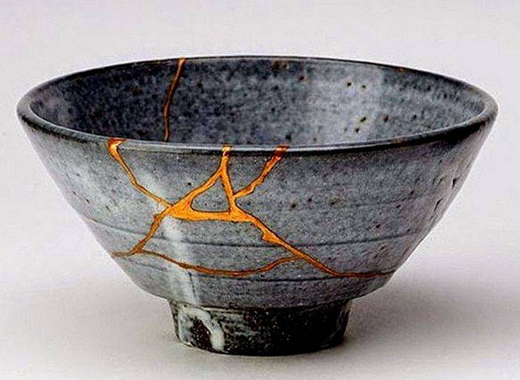

Turn that flaw into a part of the art.
Fill the cracks with gold. Or something golden, anyway..
Grey-glazed ceramic tea bowl with a flared rim and small foot, its cracks repaired with visible gold lacquer seams in the kintsugi style.

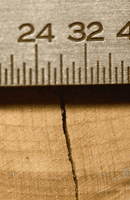

Ummmm... The largest crack is only about 1/128" wide.
Close-up of a metal ruler with printed numbers 24 and 32 above fine tick marks, resting on wood with a thin crack running down the grain.
(tick marks are 1/64" apart)
I suppose we could poke some gold leaf in there with a needle.

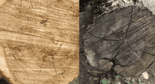

Just checked the uncooked pieces in the back yard, and it's all cracked.
Two cross-sections of cut logs side by side: the left, pale and sanded, shows radial cracks; the right, darker and weathered, shows several cracks radiating from the center.
I'm guessing the reason I didn't notice them before, was because I wasn't looking for them.
And sanding the one end filled the cracks with dust.
