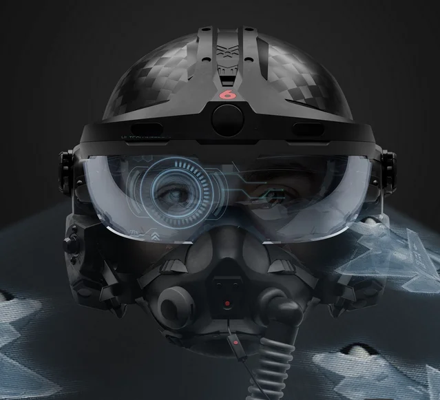

Does anyone happen to know what kind of image source Red6's ATARS system uses? Does the 18,000-nit brightness specification listed on the official website refer to the display's brightness?
That level of brightness would refer to the helmet display - where supplemental information needs to be visible even against direct sunlight.

.Scott said:
Here are the specs provided by red6ar:
And, as you can tell from the image in @berkeman's post, this is the helmet that Darth Vader will be upgrading to.
Thank you very, very much for your reply! May I ask if you know what kind of image source is used in the headset? I really can't find it and would love to learn about it.
berkeman said:
Thank you very much!Cool helmet! I want to know what kind of image source is used for the headset?
You would need to contact the manufacturer to get an authoritative answer. But I would guess it is micro-OLED technology. Micro-OLED can reach that nit rating (18,000), it's low power, and often used in this kind of application.
