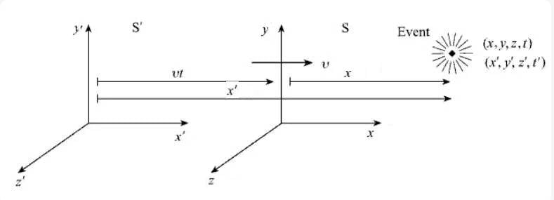

Mike_bb said:
Ok. "The second system looks from the first is indistinguishable from the first system from the second"
I wrote about it when I provided drawings for this statement. It doesn't work as it's written. Where did I go wrong in posts #15 and #19?
Each picture in #15 and #19 contains a clock and a coordinate system, that move relative to each other.
But for a visualization of the reciprocity of the two frames a picture is helpful, that contains two coordinate systems that move relative to each other.
If the directions of the x- and z- axes in both frames ##S## and ##S'## are reversed, this does not effect the equation
##c^2dt'^2-dx'^2-dy'^2-dz'^2 = k(V) (c^2dt^2-dx^2-dy^2-dz^2)##
but it interchanges the roles of ##S## and ##S'##. Then the following picture holds with primed and unprimed symbols interchanged:
Source:​
Then with the principle of relativity follows also:
##c^2dt^2-dx^2-dy^2-dz^2 = k(V) (c^2dt'^2-dx'^2-dy'^2-dz'^2)##.

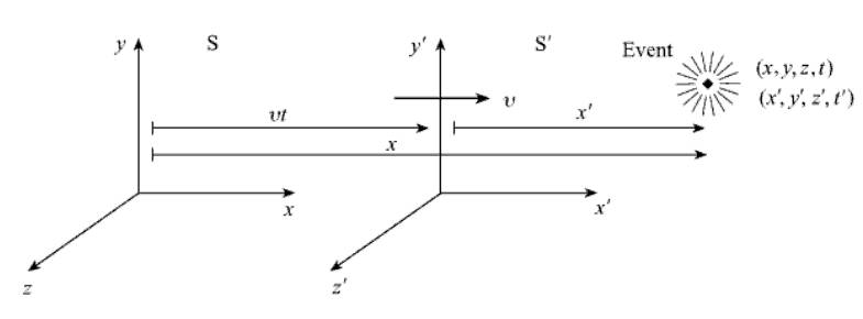

  • #35
Source:​
Am I right that after the changes it will look like this?
  • #36
The changes would also include to reverse directions of the x- and z- axes including the related arrows.
  • #37
The changes would also include to reverse directions of the x- and z- axes.
I changed x- and -z- axes on the picture. Is it true?
