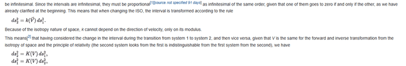

Hello!
I saw such interpretation of principle of relativity when I read proof of invariance of infinitesimally small interval:
"The second inertial frame of reference looks from the first in no way different from how the first inertial frame of reference looks from the second."
Proof of invariance of infinitesimally small interval:
If we go to the second inertial frame of reference from the first inertial frame of reference and then back we will have:
Doing such way we obtain K(V)=1 and we can prove invariance of interval.
But I can't understand what does this interpretation mean? How does it work in proof? Could anyone give example for this case?
Thanks!

The formulas you showed are reciprocal between both frames because inertial frames are homogeneous in spacetime and isotropic in space. The orientation of the rectangular axes in both frames can be arbitrary.
From for formulas you showed follows ##K(V) = \pm 1##. The negative sign can be dismissed for ##v \rightarrow 0## and then argue with continuity.

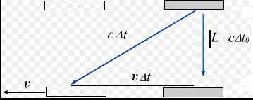

Does this interpretation work in experiment of time dilation using photon clock?
If it works then could anyone explain how? Thanks.

It works with the relativity of simultaneity. In the Lorentz transformation, ##t'## is a function not only of ##t##, but also of ##x##.

You can compare the elapsed proper times of the two light clocks in posting #4 only directly when they meet a second time (twin "paradox"). If the "moving" light clocks turns around to meet the "stationary" light clock a second time, then the scenario is asymmetrical. For calculating the time dilation in case of no turnaround, you need to involve the coordinate-time of the reference frame.

We have two reference frames: first stationary reference frame and second reference frame moving with velocity V.
Does this interpretation hold for this example?
Does this interpretation hold in this example?
Yes. According to the principle of relativity, you are also allowed to regard the first frame as moving and the second as stationary.

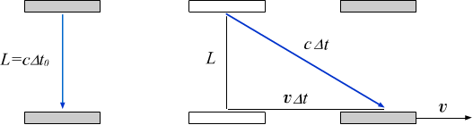

But I have a doubt about representation on picture #2 where inertial frame with photon clock is stationary and another inertial frame is moving with velocity V to the left side.
1.
2.
No matter how hard I tried, I couldn't obtain
How to obtain this equation?
Thanks!

If space and time are isotropic and homogeneous, then we can argue as follows:
Suppose the origin of one inertial reference frame (frame B) is moving relative to another (frame A). Because of our assumption, we can choose coordinates where the origin of the one frame ##O_B## is moving along the x-axis of frame A. We can formalise this and say that the position of ##O_B## is ##vt_A##, where ##v## is some constant (representing the velocity of the origin of frame B, as measured in frame A).
Note that this is something we do naturally when we tackle any kinematics problem. We choose a suitable time and space origin and choose our coordinate axes in the most suitable way. If time were not homogeneous, we would not be able to do this - there would be an absolute ##t=0## and space and/or time would be different in some way at other times. Likewise, the isotropy and homogeneity of space allows us to choose our spatial origin and x-axis as the direction of motion etc.
We can also take ##v## to be positive and, using our normal convention, if we draw a diagram of this scenario, then ##O_B## is moving along the x-axis away to the right from ##O_A##, with the two origins coinciding at time ##t_A = 0## and ##t_B = 0##.
We can see that the motion of ##O_A## as measured in frame B must be ##-v't_B##, where ##v'## is some positive constant that represents the speed of ##O_A##, as measured in frame B.
Moreover, if ##v' \ne v##, then we must have either ##v' < v## or ##v' > v##. But, the only variable we have is that ##O_B## is moving to the right. If we now change the direction of our x-axis, we find that ##O_A## is moving to the right, as measured in frame B. So, we must have ##v < v' < v## or ##v > v' > v##, corresponding to the two cases above. This is a contradiction, so we must have ##v' = v##.
And now we see that there is complete symmetry. The motion of ##O_B## as measured in frame A is ##vt_A##. And, the motion of ##O_A## as measured in frame B is ##-vt_B##. Finally, by changing the orientation of our x-axis in the second case, we can equally describe the motion as ##vt_B##. And that is exactly the same description of frame A as frame A's description of frame B.
That gives us the required conclusion that whatever A measures to be the case in frame B, frame B (by an appropriate choice of origin and orientation of the axes) can measure to be the case in frame A.
This is the fundamental symmetry argument that leads us to the conclusion that, for inertial reference frames in isotropic and homogeneous space and time, there is a single parameter ##v## that defines the relative motion between them; and that the motion of each is physically identical as measured by the other.

You can obtain your light clock drawings from the 2nd postulate (the speed of light is the same in both inertial frames, which are moving relative to each other). I propose that you use in the 2nd drawing primed coordinates because that is a different coordinate system.
Form the 2nd postulate you can also derive the formula you mentioned.

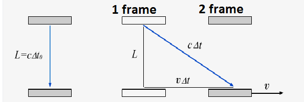

Could one drawing be enough?
From this drawing:
1. From 1st inertial frame we can see 2nd inertial frame (moving clock with velocity V) and this lead to ##{ds_2}^2=k(V){ds_1}^2##
2. From 2nd inertial frame we can see 1st inertial frame but we can't conclude that ##{ds_1}^2=k(V){ds_2}^2## because initially we agree to consider 2nd inertial frame relatively to 1st inertial frame and not 1st relatively to 2nd.

The proposition that I justified in post #16 is not directly derived from this particular scenario. Nor, in fact, does it depend on the invariance of the speed of light: the argument I made in post #16 applies equally in Newtonian space and time. Note that, as an aside, Special Relativity and Newtonian space and time are essentially the only two possibilities for homogeneous and isotropic spacetime.
I suggest that the authors have invoked this principle of equivalence of all inertial reference frames in addition to the invariance of ##c##. You may be able to justify it from the invariance of the speed of light alone - although, if you could, there would be no need for the first postulate of SR. I suspect, therefore, that you cannot justify the proposition from an analysis of a light clock alone.
In fact, my argument in post #16 is really based on the first postulate - as one of the direct implications of the first postulate is the isotropy and homegeneity of space and time.

No. The mentioned formula cannot be derived from the light clock drawings, but from the two postulates as shown in the Russian Wiki.

What does this mean roughly speaking? :
It means that you can interchange the roles of system 1 and system 2.

Ok. "The second system looks from the first is indistinguishable from the first system from the second"
I wrote about it when I provided drawings for this statement. It doesn't work as it's written. Where did I go wrong in posts #15 and #19?
