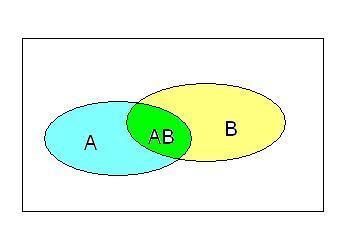

The probability is the number of favourable possibilities divided by the number of all possibilities to choose a person out of 200. The favourable possibility is that the person saw the advertisement at least at one place. The set of such people is the union of those who saw it in newspapers (A) and those who saw it in TV (B): A+B. This union of the sets can be decomposed into three disjunct sets: A\B,(blue) B\A (yellow) and AB (the intersection of A and B, green)
Calculate the cardinality of these three sets, and add them: You get all people who learned about the sale.

I totally agree with you but my question is how do you know that the 30 people that both saw the ad on TV and in the paper include the 50 people that saw it on TV and the 60 people that saw it in the paper. How do you know that the 60 people is not the blue shaded region only, the 30 the green shaded region, and the 50 people the yellow shaded region, giving a total number of (50+30+60) people who saw the ad?
Well, the text can be understood in both ways in common speach. But when a mathematician says "60 people learned about the sale from the newspaper" he/she means just that, and does not mean that they learned it only from newspaper. If they meant so they would write "from newspaper exclusively".
ehild
