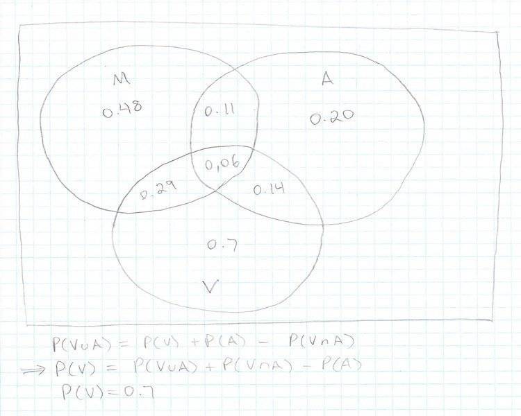

See figure attached for my attempt at drawing a Venn diagram.
I'm having some trouble finding the probability of not having a mastercard or a visa or a amex.(i.e. being outside of all 3 circles)
My attempt at this would be,
[tex]0.7 + (0.48-0.29) + (0.2 - (0.11 + 0.14 - 0.06)) = 0.9[/tex]
but that answer doesn't make any sense.
Can someone explain how to do this? Do I need to do this to get closer to finding my answer?
EDIT: After thinking about it more,
[tex]P(A \cap M^{'}) = 0.2-0.11 = 0.09 \quad \quad P(M^{'}) = 0.52[/tex]
[tex]P(A|M^{'}) = \frac{0.09}{0.52} = 0.17307[/tex]
You only need two circles like I said: see post #4.
I think that's as close as I can get to telling you how to do it without doing the problem for you.
If there are 100 people all together:
1. How many people, in total, have an amex? (given)
2. How many of the people who have an amex also have a mastercard? (given)
3. How many people who have an amex don't have a mastercard? (from 1 and 2)
4. What is the total number of people without a mastercard?
5. what is the probability that someone without a mastercard has an amex? (from 3 and 4)
That should help you understand what is behind the equations.
[edit] our posts seem to have crossed ... what's important is your method.
(I got 9/52 ≈ 0.17308 different rounding)
