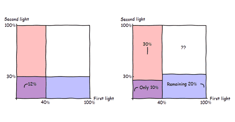

To be a little more specific about independent events -- If events A and B are independent, the probability of event A happening is the same whether B occurs or not. And the converse is true. One way to show that in a Venn diagram is to draw A as a horizontal slice of the whole diagram, and B as a vertical slice of the whole diagram. That way the percent of A within B is the same as the percent of A within the entire diagram (and vice versa). The first diagram in the attachment shows independent events and the second diagram shows dependent events
