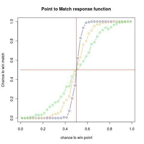

This is an example of a problem that is a hassle to analytically calculate, but trivial to simulate given an explicit value for p.
Ok -- here is a plot with
Y
% games won in green
% sets won in orange
% matches won in blue
X
% chance to win the point
Sorry for the bumpiness from low sampling, but I don't have time to remake it with higher stats.
