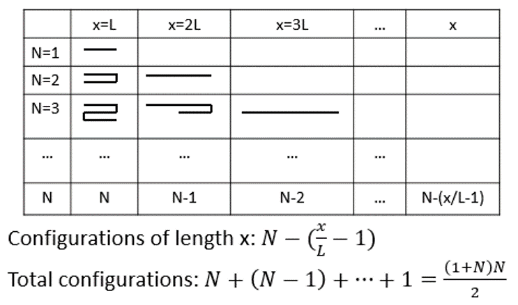

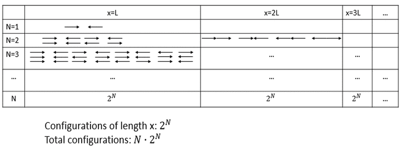

I want to check if I think it right!
If
N=1: ← or → (2 configurations/ each length is l)
N=2: ← or → or ←← or ←→ or →← or →→
(6 configurations/ folded polymer's length is l/2 andunfolded polymer's length is l)
Thus, the configuration written in the function of x:
[tex] 2^{N} \hspace{1cm}\text{ for } x=l \\ <br /> (l/x)! \hspace{1cm}\textrm{ otherwise}<br /> [/tex]
If N is the number of links of length l in the chain and x is the total length in a given configuration, how many links are in one direction and how many are in the other direction? How many ways are there are selecting the combinations of links that do this? (This is like a coin flipping problem).

oh!So the length l doesn't mean the total length?
NO, it's the length of each link.
Thanks! Reading mistake!

Actually, I have another question. How come the second question asks about the total number of configurations? In my opinion, there are infinite configurations depend on unlimited x. Does the question ask about the average configuration number?

For a specified x, there are not an infinite number of configurations (at least not in 1D).

But, I think the first question asks the total number of specific x. Or, can the polymer be folded? This really make the answers of two questions different.
It seems to me the implication is that it is folded along a straight line.

I don't think so. You need to figure out for a chain of identical joined links that can be folded along the x axis. So, for x = L, and N= 2, there are zero configurations. Leave off the arrows. For x = 2L and N = 2, there is only one configuration. For x = L and N = 1, there is only one configuration.

No. It's just if there is a fold or not at each jumction. The focus should be in the junctions, not the links.
Kelly Lin said:
Also, why can't N=2 chain be folded? Thanks!
Yes If N=2, you can have x=1 with a fold.
So you mean if N=2 there are 3 configurations?
If N is 2 and x is 2, then there is 1 configuration. If N is 2 and x is 1, I would have to decide whether there are 2 configurations or 1. My inclination would be to count it as 1 configuration.
I think this is more viable!

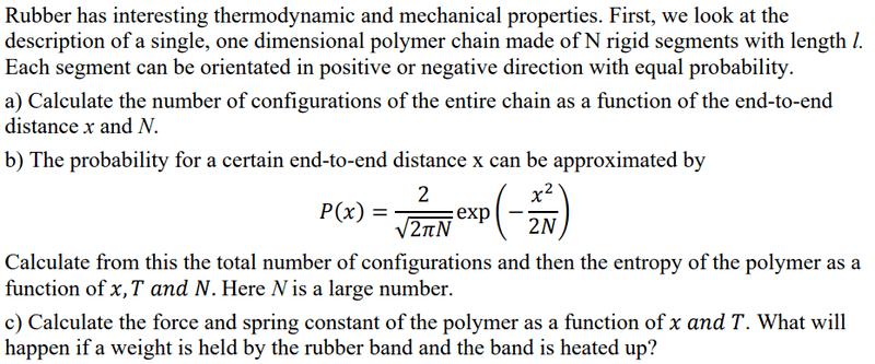

For the entropy in the system,
since
[tex] S=-k<lnP_{r}>=-k\sum_{r}{P_{r}lnP_{r}}[/tex]
we get
[tex] S\approx -k\int{P(x)lnP(x)}dx=...=(-\frac{k}{2})(1-ln(\frac{2}{\pi N}))\approx -\frac{k}{2} \\<br /> A=-\int S dT = \frac{1}{2}kT \\<br /> U=A+TS=\frac{1}{2}kT-\frac{1}{2}kT=0[/tex]
*A=free enegy; U=internal energy
So weird that U=0. Am I doing this wrong?? Thank you!

Suppose r of the N are oriented one way and the remaining N-r the other way. What would the total length be?
By the way, the expression on the right in b) cannot correct. The argument to exp() must be dimensionless, but x is a length. I would rewrite it by replacing x by x/l everywhere.

The result will be [tex]x=Nl-(N-r)l=rl[/tex]
Oh! Then the configuration will be [tex]\frac{N!}{r!(N-r)!}=\frac{N!}{(\frac{x}{l})!(N-\frac{x}{l})!}[/tex]
But, x can also be (N-r)l so the configuration above have to be multiplied by 2.
However, in this point of view, we view each section independently as an arrow. In the real situation, polymers will always turn their direction in the end. So, I think my table is more viable, right?
Although it is repalced by x/l, my result is still weird.(I got U=0)

You have the answer for qn a). For b), you need to divide by the total number of possible orientations of the N to get a probability. Are you familiar with Stirling's approximation for factorials?
For ease of algebra, I would work with r rather than x/l.

Shouldn't x be ##x=|(N-2r)l|##?
Thanks, I forgot to check that.
