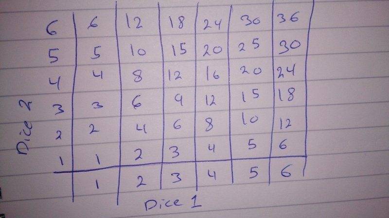

Two fair dices are thrown and the product of the numbers on the dice is recorded, given that one die lands on 2, find the probability that the product on the dice is exactly 6
P(A|B)=P(AnB)/P(B)
I drew the table of the products
The intersection is 2/36
But how can I find the probability of landing on 2?

Looking at your outcome table: How many combination of dice rolls end up with at least one 2?
2 combinations? 2 and 1, and 1 and 2
What about 2 and 3 or 2 and 4? Those have at least one 2.
Edit: Let me put it this way. How many combinations have a 2 on Die 1? How many combinations have a 2 on Die 2?

So total of 10 combinations right?

This depends on how you interpret the problem formulation (which is not clear). If the formulation is that only one die should show a 2, then 10 is correct. If the formulation also allows both dice showing 2, then you get an additional possible outcome.

This would depend on problem formulation. As you have formulated the problem above, I would interpret it as at least one die landing on 2. Other possibilities would include:
  • Dice 1 landing on 2 and Dice 2 arbitrary.
  • Only one die landing on 2 and the other on a different number.
I would say it is up to the problem maker to formulate the problem such that it is unambiguous what is intended. For the case of at least one die landing on 2, the possibilities are the 10 possibilities I suspect you counted (2x and x2 where x is not equal to 2) plus the possibility of both dice landing on 2.
