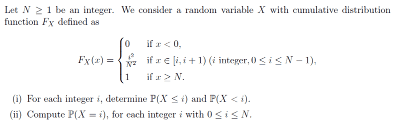

Please see below
F(X) = P(X ≤ x)
Typeset problem statement defining a random variable X with piecewise CDF F_X(x): 0 for x < 0, i^2/N^2 for x in [i, i+1), 1 for x >= N, followed by parts (i) and (ii).
I have tried to answer all the questions but I am not that sure with my answer.

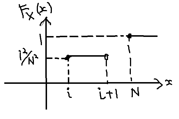

Hand-drawn step graph of a cumulative distribution function F_X(x) against x, with a step of height i^2/N^2 from x = i to x = i+1 and a step up to 1 at x = N.
That's the graph of ##F_X (x)## (I think)
(i) P (X ≤ i) = ##\frac{i^2}{N^2}## and P(X < i) = 0
All of these are based on the graph
(ii) P(X = i) = P(X ≤ i) - P(X < i) = ##\frac{i^2}{N^2}##
Are my answers correct? Thanks

If there are several integers between 0 and i, they have positive probability values. so P(X<i) > 0.

No. Notice that your diagram only has one i < N, but there might be several others. Also, the sum of the probabilities must equal 1, so your diagram is missing a lot of probability.

Ah, I see. Now I understand the question
Revised attempt:
(i)
$$P (X ≤ i) = \frac{i^2}{N^2}$$
$$P(X < i) =
\begin{cases}
0 & \text{if } i= 0 \\
\frac{(i-1)^2}{N^2} & \text{if } i>0
\end{cases}
(ii)
$$P(X = i) =
\begin{cases}
\frac{2i-1}{N^2} & \text{if } i>0
\end{cases}
For P(X < i) and P(X = i), is there an answer not involving piecewise function? Thanks
