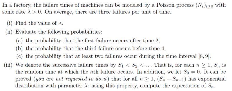

Typed problem statement on a Poisson process with rate λ, where failures average three per unit time. It asks for λ, probabilities about the first, third and failure counts in given time intervals, and the expectation of the nth failure time Sn.
My attempt:
(i) ##\lambda =3##
(ii)
(a) ##P(N_{2} \geq 1=1-P(N_{2} =0)=1-e^{-6} \frac{(-6)^0}{0!}=0.997##
(b) ##P(N_{4} \geq 3)=1-P(N_{4} \leq 2)=0.999##
(c) ##P(N_{1} \geq 2) = 1-P(N_{4} \leq 1)=0.8##
Do I even understand the question correctly for part (i) and (ii)?(iii) The expectation of exponential distribution is ##\frac{1}{\lambda}## so the answer is ##\frac{1}{3}##?
Thanks
Yes, I think so, but there are a couple of errors in notation.
In (a), (-6)0 should be 60.
In (b), N4 should be N1.
Otherwise it looks correct.
For (iii), what are you calculating the expectation of?
Here is a simple sanity check of your answer for (ii)(a):
On average, there are three failures per unit time. Your answer for part (ii)(a) is that it is almost certain that there are no failures in two time units. Does that seem right?

Yeah, it does not make sense.

Sorry I don't understand why it should be N1, maybe I am misunderstanding something again.
N = number of failures
t = time interval
Is that correct?Revised attempt:
(ii)
(a) ##P(N_{2} = 0)=e^{-6}=0.0025##
(b) still the same as post #1
(c) still the same as post #1, with a revision ##N_{4}## should be ##N_{1}##
Oh wait, maybe you mean the error in notation is for (c) instead of (b)? @mjc123
Oh my god, the expectation of Sn
$$E(S_{n}-S_{n-1})=\frac{1}{\lambda}$$
$$E(S_{n})-E(S_{n-1})=\frac{1}{\lambda}$$
$$E(S_{n})=\frac{1}{\lambda}+E(S_{n-1})$$
Not even sure this is the correct approach
Thanks
Oh no, yes I meant c not b. I must have been half asleep that day. Apologies for confusion.
(iii), you're on the right track.
S0 = 0
E(S1 - S0) = 1/λ
E(S1) = 1/λ
E(S2 - S1) = 1/λ
E(S2) = ?
etc.
