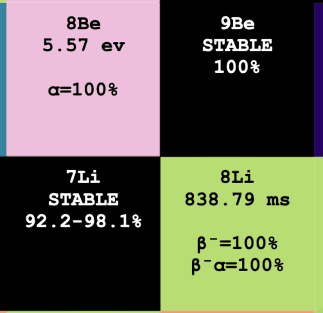

Thank you all very much, your insight is invaluable, and I believe I can use this to move forward. One final question, however (and sorry if I'm asking too many of them), but I can assume that most of the energy released is split between the two alpha articles, right (given the small mass of the beta particle in going from lithium-8 to beryllium-8)?
Thanks for the help. I believe I have the correct alpha (kinetic) energy now pegged at around 10 MeV, taking it as a single-step, nonrelativistic scenario. Thank you all for your help!
