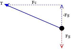

Here is a diagram:
http://i55.tinypic.com/k18g14.jpg
A ball of mass 0.75 kg on the end of a cord is swung in a circle of radius 1.5 m with a period of 1.5 s as shown in the diagram.
a.) What is the speed of the ball?
b.) What is the acceleration of the ball?
c.) What centripetal force must be exerted by the cord to keep the ball in orbit?
d.) What is the mass of the central object? (Hint: Use Pythagoras' theorem to calculate the force of tension in the string.)
e.) What angle does the cord make with the vertical?
f.) How long is the cord, L?
Velocity = 2(pie)r / T (T = period in seconds)
Acceleration centripetal = v^2 / r
Force centripetal = mv^2 / r
I know all parts except for d, e and fa.) velocity of ball is 6.28 m/s
b.) centripetal acceleration of ball is 26.3 m/s^2
c.) centripetal force of ball is 19.7 N
d.) ??
e.) ?
f.) ?
Thanks
The force of gravity on the hanging central weight provides the tension force in the string to the ball. This includes both the centripetal force and the upward force necessary to counteract gravity on the ball.
Free-body diagram of a ball on a string: blue arrow T along the string to upper left, dotted horizontal arrow Fc to the left, dotted upward arrow -Fg, and red downward arrow Fg.
The ball is not accelerating vertically, so the upward component of T equals the mg down. The tension in the string and thus the weight of the hanging weight can be calculated from the known mg and Fc. Careful with the angle - question asks for angle with vertical, so likely something larger than 45 degrees.
