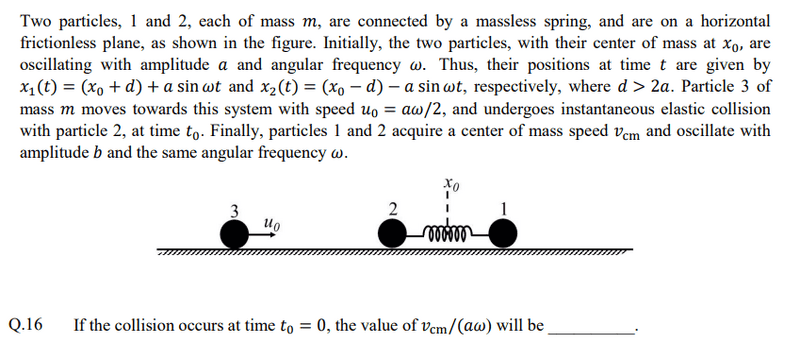

Two particles, 1 and 2, each of mass 𝑚, are connected by a massless spring, and are on a horizontal frictionless plane, as shown in the figure. Initially, the two particles, with their center of mass at 𝑥0, are oscillating with amplitude 𝑎 and angular frequency 𝜔. Thus, their positions at time 𝑡 are given by
𝑥1(𝑡) = (𝑥0 + 𝑑) + 𝑎 sin 𝜔𝑡
and
𝑥2(𝑡) = (𝑥0 − 𝑑) − 𝑎 sin 𝜔𝑡, respectively, where 𝑑 > 2𝑎.
Particle 3 of mass 𝑚 moves towards this system with speed
𝑢0 = 𝑎𝜔/2, and undergoes instantaneous elastic collision with particle 2, at time 𝑡0. Finally, particles 1 and 2 acquire a center of mass speed 𝑣 cm and oscillate with amplitude 𝑏 and the same angular frequency 𝜔.
p=mv, coefficient of restitution, SHM equations

this is the problem statement,

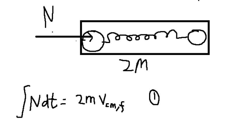

Handwritten sketch of a block of mass 2m containing a spring between two balls, with a force N applied to the left ball, and the equation integral of N dt = 2m V_cm,f labelled (1).
I have attempted by considering 1+2 as a system, and the only external force on it during collision, which causes a change of momentum of the system, which I think is the change in momentum of the center of mass (maybe wrong). clearly from the velocity equations above, the center of mass has an inital V_cm=0. so the inital momentum is 0.

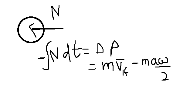

Handwritten sketch of a circle with a short line from its centre to the right, labelled N, followed by -∫N dt = Δp = m V₁f - m a ω/2.
similarly here is ball 3 during the collision. I have assumed the velocity right after the collision as V_1f.

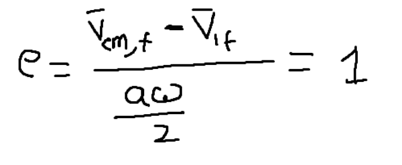

Handwritten coefficient of restitution equation: e = (v_cm,f - v_1f) / (aω/2) = 1, with the numerator's velocities written with bars above them.
coefficient of restitution equation.
solving all of these, I end up with a wrong answer,

I would not consider 1+2 as a system. I would consider finding the speed of particle 2 immediately after the collision with 3. I would assume that the velocity of 1 does not change appreciably while the collision takes place. Thus, I know the velocities of 1 and 2 after the collision.

why not consider 1+2 as a system? I have tried what you have suggested and I got v final as 3/4 aw which indeed is the right answer. But why is what i did incorrect?

You treated 1 and 2 as though connected by a rigid rod. This led to too much momentum being transferred to those two. As @kuruman and I have shown, you can treat the collision as only involving 2 and 3. Its effect on 1 only comes later.
Bear in mind that particle 1 doesn’t "know" about 2 and 3. All it experiences directly is the force from the spring, and that depends entirely on the length of the spring. The collision doesn't suddenly change the length of the spring, only the velocities of particles 1 and 2, so not even the acceleration of particle 1 changes instantly, let alone its velocity.

Let me add that in your expression for the coefficient of restitution you are considering the collision between mass 1 and the CM. Mass 1 collides with mass 2, not the CM. That's what we've been trying to tell you.

okay but as per the force diagram it seems as if the system masses 1+2 is experiencing a force N, which should lead to a change in momentum of the velocity of the CM. I have been told that external forces acting on a body are external forces on the system.

It does indeed lead to a change in velocity of the CM, but not as great as if masses 1 and 2 were connected by a rigid rod.
Forget the spring for a moment. There is nothing to stop you considering masses 1 and 2 as a system even though they're entirely disconnected. If, initially, 1 and 2 are at rest then the collision will leave 3 at rest and 2 heading towards 1 at velocity ##u_0##. The CM of 1+2 is now moving at velocity ##u_0/2##.
Alternatively, if we replace the spring by a rigid rod, the collision will leave 3 rebounding at speed ##u_0/3## (velocity ##-u_0/3##) and the 1+2 CM moving off at velocity ##2u_0/3##.
Work and momentum are conserved in both cases.

Your equation beginning “e = " is Newton’s Experimental Law. It assumes the two masses are rigid bodies, and that they are not rotating.
For the e=1 case, it can be derived from momentum and work both being conserved, work being taken to be the sum of the KEs of the two bodies. But the KE of the 1+2 system is more than ##\frac 12(m+m)v_{cm}^2##.

so the mistake I am making is misuse of newtons experimental law?

Yes.
