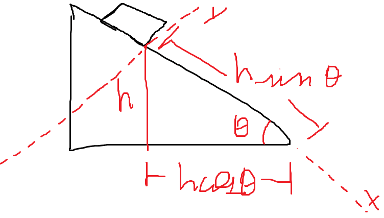

Hello! I'm here again, now with a new exercise! :biggrin:
A block of mass m is at rest over this wedge (it's a triangle) of mass M that is at rest over a table. There is no friction. The point P of the block has a height h from the table. Then the block starts to move. What's the velocity of the wedge (triangle) when the point P hits the table? There is a picture from my textbook so you can see the situation.
Well, since this exercise is from the Center of Mass chapter I tried to solve this by using center of mass. I know the coordinates of the center of mass they are ##x_{CM}## is ##2a/3## and that ##y_{CM}## is ##2b/3## (imagine a rectangle triangle). But the problem is that I have no ##b## or ##a## so I'm stuck. The only thing I was able to calculate was the velocity of the block when it hits the table ##\sqrt{2gh}=v## but it doesn't help at all. So, I'm stuck so I would like a hint to go on.
Thanks!
That's the center of mass of the wedge, but you need to consider the center of mass of the system. What can you say about the velocity of the system's center of mass?

The only force that makes the wedge move is ##mgcos\theta sen\theta## so the velocity of the wedge is related to this force. *just a random thought*
Check out my draw below. What I'm trying to say is: if we think about the block as a point (point P), we might use those things I wrote in the draw to calculate the x coordinates of the center of mass of the system. IF I'm correct then the x coordinate of the center of mass would be ##x_{CM}=\frac{m.hcos\theta +M\frac{a}{2}}{m+M}##. But this is not good 'cause I don't know the length ##a## of the wedge.
Check out my draw above. What I'm trying to say is: if we think about the block as a point (point P), we might use those things I wrote in the draw to calculate the x coordinates of the center of mass of the system. IF I'm correct then the x coordinate of the center of mass would be ##x_{CM}=\frac{m.hcos\theta +M\frac{a}{2}}{m+M}##. But this is not good 'cause I don't know the length ##a## of the wedge.
You shouldn't need to deal with picky details like particular forces, lengths, or locations if you work with the conservation laws :wink:

But you guys are saying "what's the center of mass of the system" and "what's the velocity of the center of mass". This is what I calculated above right?

You don't seem to be incorporating the angle of the incline into the problem at all.

This is what I did: [itex]F=ma_1 → mgsen\theta=ma_1(\theta) → -gcos\theta=v_1(\theta)[/itex] and [itex]F=Ma_2 → Mgcos\theta sen\theta = Ma_2(\theta) → -gsen\theta cos\theta =v_2(\theta)[/itex] Then I plugged these equations on the energy statement and it won't work. I think this is not the way...
I didn't set it up with a force equation, I just looked at the final velocity for m. Part of it is downwards and only part of it is sideways, therefore you can't say that [itex]mv_{1} = Mv_{2}[/itex], you need to have a trig function in there to talk about only the horizontal comonents of the motion.
Conservation of momentum in the x direction gives you ##mv_{x_1} = Mv_{x_2}##. You might be tempted to say ##v_{x_1} = v_1 \cos \theta##, but that's not correct. The velocity of the block relative to the wedge makes an angle ##\theta## relative to the horizontal, but because the wedge is moving, ##\vec{v}_1## points at an angle greater than ##\theta## below the horizontal.
Start by expressing ##\vec{v}_1## in terms of ##\vec{v}_2## and ##\vec{u}##, the velocity of the block relative to the wedge.
