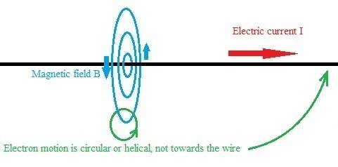

I've been discussing this elsewhere recently. In my opinion Purcell's explanation in section 5.9 doesn't actually explain why an electron moves in a circular or helical fashion in a magnetic field:
However this length-contraction explanation has been around for so long that's it's rather taken for granted.

Hi John Duffield, welcome to PF!
An electron has a circular or helical path in a uniform magnetic field, but the field around the wire is not uniform. So the path is pretty complicated even using Maxwells equations directly. I wouldn't expect any simple qualitative explanation to cover it, you would really need math.
If you consider an infinite uniform sheet of current, the quantitative calculation is easier.
In both that case and case of the wire and its non-uniform field, we can calculate that when the test particle is moving radially (perpendicular to the current direction) there will be an axial force (parallel or anti-parallel to the direction of the current) while if it is moving axially the force will be radial. In general, the velocity of the particle can be decomposed into axial and radial components, and the resulting radial and axial forces add to produce the circular motion we're looking for.

Thanks Dale and Nugatory. The point I wanted t make was that Purcell's description suggests that an electron moves towards the wire, when actually, it doesn't. Yes, the magnetic field around a single wire is not uniform like it is inside a solenoid, but the electron still moves around the magnetic field lines. It doesn't cross directly over them towards the wire. See images of electron motion. I cannot explain the reason for this discrepancy. Perhaps it's the way electromagnetism is taught. For example see section 11.10 of Jackson's Classical Electrodynamics where he says "one should properly speak of the electromagnetic field Fμν rather than E or B separately". There’s no problem with that, but IMHO it ought to come much earlier, because the real reason for the electron’s circular/helical motion is the "spinor" nature of the electron electromagnetic field.
Isn't it more about the instantaneous force on an electron with a specific instantaneous velocity, rather it's path over time?

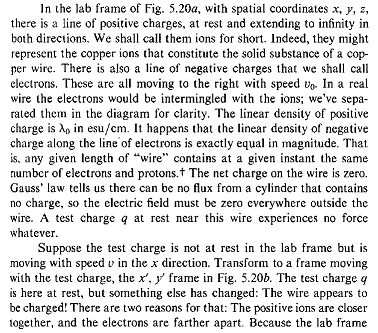

I have Purcell in front of me, open to section 5.9. I don't see any claim such as the one you impute to him. Could you tell us what edition you're looking at, and give us an accurate quote so that we can understand what you're referring to?

The force on a charge ##q## moving with velocity ##\bf{v}## in a magnetic field ##\bf{B}## is ##q \bf{v} \times \bf{B}##. If ##\bf{v}## and the wire are parallel, then, since the cross product is perpendicular to ##\bf{v}##, the force is perpendicular to the wire. See diagram (c) on page 194 of the second, page 260 of the third.
John Duffield said:
The charged particle doesn't move towards the wire. It moves rotationally around the magnetic field lines.
In a constant magnetic field, a charged particle moves in a circle or helix around the magnetic field lines. The magnetic field around a current-carrying wire is not constant.
A free charged particle, acted on only by the field, would move the way you describe. However that is irrelevant to the example presented. He specifies that the motion is parallel to the wire and then calculates the force on the particle. A problem where the motion is specified and the force is calculated is a different problem than one where you calculate the equations of motion.

Your comments noted. We see forces like this → and this ↑ but not like this ⥀ .
They are the same thing, as the magnitude and sign of the forces in the horizontal and vertical directions change with the direction of motion of the particle. Their vector sum is always a force that is perpendicular to the direction of motion... And that's circular motion.
The thing is that when you replace the wire with a charged rod, adding two vectors like this → and this ↑ gives you this ↗ with an increasing upward component as per my OP depiction. Look closely at page 193. See where it says the electrons are moving to the right at a speed of v₀ and the test charge at rest near this wire experiences no force whatever? Now imagine the test charge also moves to the right at a speed of v₀. Motion is relative. We now have a situation wherein the ions are effectively moving to the left at a speed of v₀. So the test charge still experiences no force whatever. But if you throw the test charge along the wire at the drift speed, it doesn't keep going in a straight line. It goes around the magnetic field lines. There are issues here. Particularly when you try applying the wire appears to be charged! to a loop. It contains n electrons whether they're motionless or circulating. The charge density doesn't increase. Page 19 of this paper looks interesting: ‘It is important to note that no contractions are involved from the standpoint of the laboratory frame, but only from the standpoint of a frame moving relative to the laboratory. The only difference between a wire carrying a current and a wire not carrying a current is the existence of a drift velocity for the electrons. The mean distance between the electrons remains unaffected as measured in the laboratory frame.’
This is another correct statement by Purcell. Your examples all point to correct statements.
This is not correct. Motion is relative, but the scenario is not symmetric between these two frames.
I don't know how familiar you are with relativity. Are you familiar with four-vectors? The charge density and current density together form a four-vector. It makes it easy to see that there is a nonzero charge density in the drift frame.
Have you actually worked this out? It is a worthwhile exercise. For simplicity, consider a square loop, with two sides parallel to the direction of motion. Run the numbers and see if there is actually an issue applying it to a loop.
John, I am not a big fan of Purcell's approach as a teaching tool. But it is factually correct. If it is not helping you learn, then I would drop it and read a different book. But you are "tilting at windmills" here.
As DaleSpam said, there is no symmetry between the rest frames of the ions and the electrons. The ions are fixed in a grid, so they keep their spacing in their rest frame when the current is switched on. The electrons aren't fixed so when the current is switched on, they change their spacing in their own rest frame.

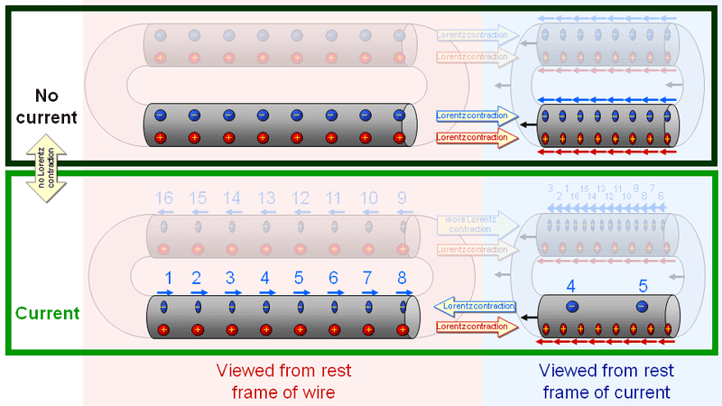

See this diagram by DrGreg:
From this old thread:
https://www.physicsforums.com/threa...-of-electrostatics.577456/page-3#post-3768045
AT: try your scenario for a loop of current. It just doesn't work.
It's symmetric enough. Draw it out:
I consider myself to be a "relativist", and a guy who "roots for relativity", and yes, I'm familiar with four-vectors. And Lorentz invariance.

The diagram above shows a loop.
What exactly doesn't work?
Then briefly. In the lab frame (and in units where c=1) the proton four-current is ##(\rho_0,0,0,0)## while the electron four-current is ##(-\rho_0,-\rho_0 v_0,0,0)##, where ##\rho_0## is the density of conduction electrons in the lab frame and ##v_0## is their velocity in the lab frame. This gives a total four-current of ##(0,-\rho_0 v_0,0,0)##.
Boosting to a frame moving at ##v## wrt the lab in the direction of the current we get that the proton four-current is ##(\gamma \rho_0, -v \gamma \rho_0,0,0)## and the electron four-current is ##(\gamma (v_0 v-1) \rho_0, \gamma (v-v_0) \rho_0,0,0)##. This gives a total four-current in the moving frame of ##(\gamma v_0 v \rho_0, -\gamma v_0 \rho_0,0,0)##
