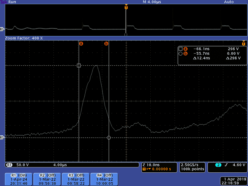

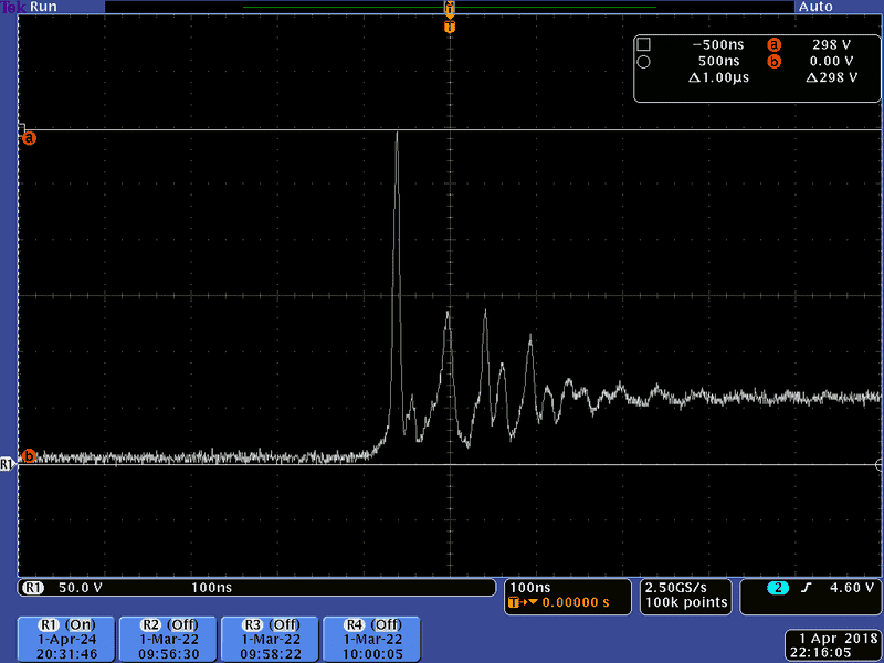

Hello,
I am working on the design of a flyback converter based on the LT3751 capacitor charging circuit. My design is similar to the 42 A cap charger example on pg. 25 of the LT3751 datasheet. In my case, the circuit runs on 12V and steps up the output to 430 V, but I am having some major noise issues with the MOSFET driving the primary of the transformer. The flyback powers some other high voltage circuitry and the noise from the FET during turn-off is radiating into the other parts of the design, both through the power and ground lines and through the air.
My first attack plan was to add an RC/RCD snubber across the primary of the transformer to snub the high frequency oscillations on the switch. But for some reason, none of the values I calculated for it, (or just plan experimented with) had any real impact on the waveform—in particular, the first high voltage spike, which is rising to as high as 200V. I have attached scope shots of the turn-off waveform, including a closeup of the first spike, which is around 12 ns wide. One challenge is that this waveform's spike is so narrow, and also the waveform seems to be rich in harmonics.
Has anyone run into problems like this before or seen a waveform such as this which seems to defy normal RC/RCD snubbers? I'm not sure what to try next to remove this noise.

Can you upload the schematic and describe where you are putting the snubber? Can you post the winding stackup and winding information for the transformer? Do you have the flexibility to wind the transformer differently, or are you using a stock unit that you can't change? There is a trick in the winding stackup that can help to reduce that ringing (when used with a good snubber circuit).
Hello Berkeman,
Thank you for your response. I have attached a basic schematic of the flyback circuit showing the parameters of the power stage and position of the RCD snubber I've been playing with. The transformer itself was a custom-wound part from Sumida based on a recommended part number from the LT3751 datasheet (Sumida PS07-300) so I'm not sure how they wound it internally. The only difference between the part number listed above and the one we're using is that it was wound with higher voltage wire. All other parameters are the same.
So, a few thoughts:
  • There does not seem to be much in the way of high-frequency decoupling at your power input. The HF impedance of that 470uF electrolytic cap is probably not going to let the snubber circuit damp the high-frequency oscillation that your first 'scope pictures shows. Consider adding more HF decoupling at the input, and see if that helps the snubber to work better
  • I didn't see the RC values that you are using for the snubber (I could have missed them). In a recent power supply we used 0.01uF and 499k. I was inclined to use smaller values of the resistor, but there is a tradeoff in efficiency loss if you have to absorb too much energy in the snubber resistor
  • The input inductance of the primary seems a bit low for your switching frequency, but I guess if the IC manufacturer recommends that transformer design, it must be about right.
  • I'd recommend that you ask the transformer house to show you the layer stackup for the transformer. Often they wind the primary 1/2 against the core and the other 1/2 as the outer layer outside of the secondary. They do this to reduce the leakage inductance Lk. But this puts 1/2 of the noisy primary on the outside of the transformer which can lead to more noise coupling and EMI. We recently were working with Wurth on a power supply design, and they re-wound our transformer with all of the primary as the innermost layer, then a grounded shield layer, then the secondary layer. This helped a lot in reducing our noise and EMI (along with improved decoupling).
Maybe give some of those ideas a try to see if they help. Let us know how it goes please. :smile:

The 12nS spike you are seeing is probably from the distributed capacitance of the transformer. Using the 300nH leakage inductance, to resonate at 41.7MHz takes 49pF. A 100V Zener closely and directly wired across the primary may clamp the spike, easy enough to try. Watch out for power dissipation at different load conditions. A different transformer configuration may help... so may a board layout change. For instance a board pad under the transformer connected to one end of the primary may help. Try it on both primary leads (not at the same time! :oldsurprised:).
The "conventional" (cheap) cure for inductive kickback is R and C in series directly across the inductor. In this case your R would have to be above 2 Ohms to get the needed 100V spike on the primary. Unfortunately a 110uF cap with that transformer resonates around 10kHz, or 50uS for a half cycle. So that wasn't as good an initial approach as I had hoped. To get the resonant frequency high enough to not interfere with the next pulse, the cap must be less than 500nF. That would also be the upper limit for the present snubber circuit. You could try a few ohms of resistance in series with the present snubber capacitor to limit the current increase at turn-on.

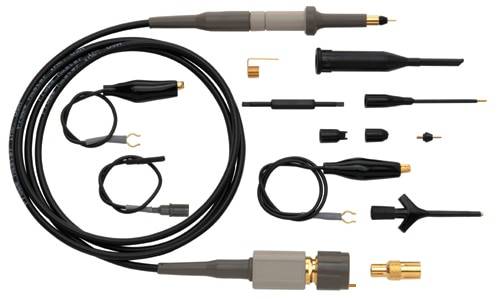

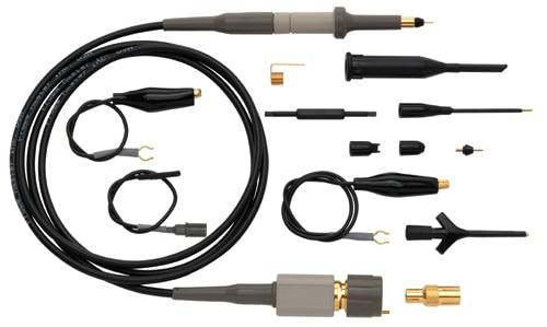

BTW, how did you probe this signal? If you used a conventional 'scope probe with ground lead and clip, some of that ringing can be in the 'scope probe inductance itself. For probing high-frequency waveforms like that with a 'scope, it's best to use a "Z-Lead" probe tip like in the picture below.
Also, some of that ringing can be due to common-mode to differential-mode conversion in the scope input. One way to tell how much this is adding to the ringing is to try a "ground minus ground" check, where you leave your conventional probe ground clip connected, and probe that same ground with the probe tip. If the common-mode spike is getting converted into what looks like a differential signal, you will still see much of it during this ground minus ground sanity check.
Z-lead accessory is the small gold-colored ground ring + tip just below the end of the probe in this picture. It slips over the bare end of the probe, with the ring part making contact with the ground ring of the probe tip, and projects a short, sharp ground tip to make contact with your circuit right next to the signal you want to probe. This can reduce the probe's ground loop inductance by a couple orders of magnitude. Of course you need to have a ground probe point next to your signal probe point on the PCB in order to use this type of probe...

Another trick with the 'scope probe is to use a Ground lead long enough to wrap around the probe several times, space the wraps over the length of the probe. Of course you still need to have a nearby Ground point.
http://cdn7.bigcommerce.com/s-9x745...s/105/276/5904RA-lg__28096.1433344387.jpg?c=2
EDIT -- Fixed a typo in one of the sentences...
This is a REALLY good point. I literally just found out a few days ago that I shouldn't have been using the normal grounding clip with the scope probes for HF measurements! Thankfully, the probes I have did come with the spring-tip contacts so I'll be using those for testing moving forward. However, unfortunately, the way I laid out the current PCB, there are no close ground points near the drain or primary connections where I can take good measurements. I'll make sure to include some test point pads (any recommendations for test points?), for the next version to make this easier.
This is a good idea here. Thankfully I do have the spring tip ground connections that berkeman showed in the picture above, though I don't have any nearby ground points to measure it with directly.

Another thought: 12ns in an electrical lead where c=20cm/ns adds up to 2.4m or 1.2m back and forth. Is that the length of your oscilloscope lead?
Actually, that's a really good question. The scope probe I used for the original measurement had a lead length of 1.98 Meters from the end of the cable to the tip of the probe head. Not sure if this directly correlates?
It could. The OEM probes have a resistive center conductor (400Ω in the one I just checked) to suppress such things, I haven't found that in the one or two cheap replacements I've checked.
At one job I did, they couldn't figure out why some 'scope readings were not reproducible. They had saved money with some cheap imported probes. The probe designer saw the 10MΩ input impedance spec and dutifully put a 10MΩ resistor in the probe! Oops.
