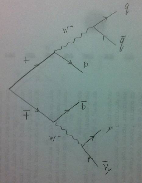

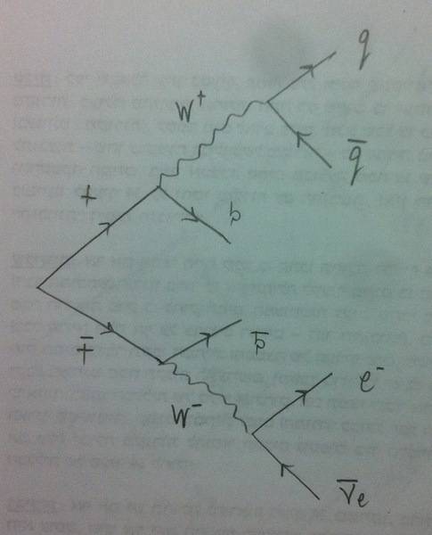

The decays i was talking about are
or
or
While I'm at it, how would a Feynman diagram look for, say, the first ttbar decay?
There is also ##t \bar t \to b \bar b q \bar q q \bar q## but it is a tricky channel experimentally.
Both top decay to Wb, the W then decay either to lepton+neutrino or quark+antiquark.

First off thanks for the help ChrisVer and mfb. I asked about the diagrams because I wasn't feeling pretty confident with what I'm drawing. But I tried understanding this better yesterday and I hope I got this right. Attached are 3 figures of the Feynman diagrams for the 3 decays I described above. I'd be happy if you guys could take a look at them and tell me if I did this correctly or give out some remarks. I can provide an argument for each if needed.
First decay
Second decay
Third decay
Thank you!

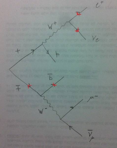

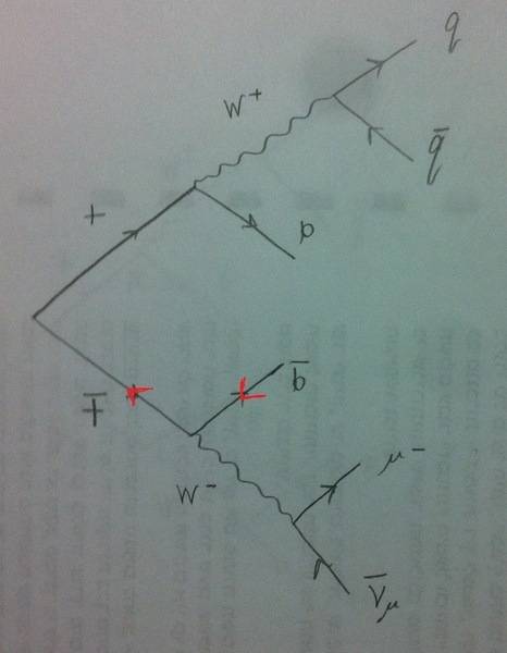

Correct.
And all the other decay modes work in the same way.
Edit: Didn't check the arrows. Orodruin is right, some of them point in the wrong direction.
Your fermion flows are not correct. You should take care in which way the arrows of your fermion lines go. In the standard model, the fermion flow never changes direction.
also if you want to be extremely scholastic, writing [itex]q\bar{q}[/itex] on the diagrams can be misleading... the reason they write [itex]\bar{t}t\rightarrow b \bar{b} q\bar{q} l \nu[/itex] is to make it readable (in fact read the quarks as jets)... In the diagram you should make sure you prime the quarks coming from the Ws, in explicitely [itex]W\rightarrow q \bar{q}~'[/itex], because the two quarks are not each others' antiparticle (eg you don't have [itex]W \rightarrow u \bar{u}[/itex]).
So the arrows on the W+ decay on each of the 3 ttbar decays is opposite?
Ws don't need an arrow...
the arrows for antiparticles [as you plot the diagrams] should look to the left (so for example some W product(s)-find them out- and [itex]\bar{t}\bar{b}[/itex] are wrong).
the arrows for particles to the right.
To start with, all of your tbar arrows are in the wrong direction.

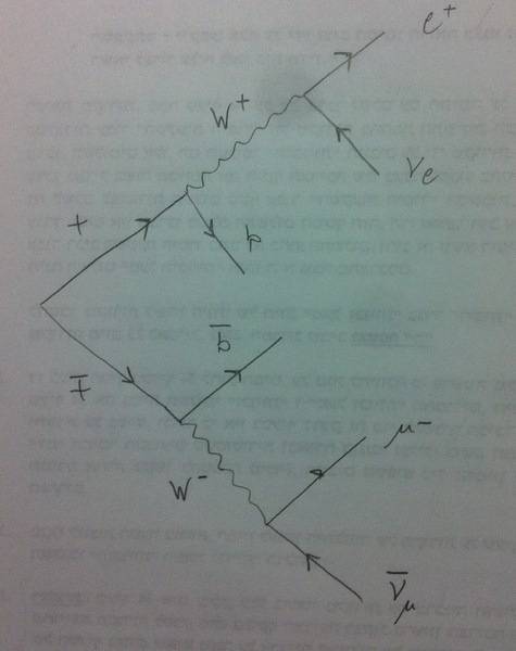

Antiparticles always have their arrows go against the time direction. You can tell it's a ttbar process (including the decays of the tops) because you start with ttbar production (the production process is currently not part of your diagrams) and you have different outgoing particles.

How about now?
they look OK,
