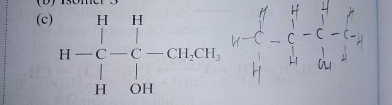

when compund P ( CH2=CHCH2CH3) and Q ( CH3CH=CHCH3) is reacted with steam , compound T which is optically active formed. draw the structure of T . the ans is on the left. my ans is on the right. is my ans ( on the right) accepted , why and why not?

First of all: is it different?
