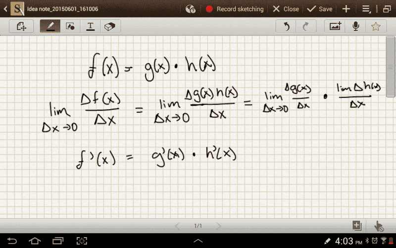

Why wouldn't this work?
Because
\lim_{\Delta x\to 0}\left(\frac{\Delta(g(x)h(x))}{\Delta x}\right) \neq \lim_{\Delta x\to 0}\left(\frac{\Delta g(x)}{\Delta x}\right)\lim_{\Delta x\to 0}\left(\frac{\Delta h(x)}{\Delta x}\right).
It is unclear why you think these expressions would be equal on quite a few levels.

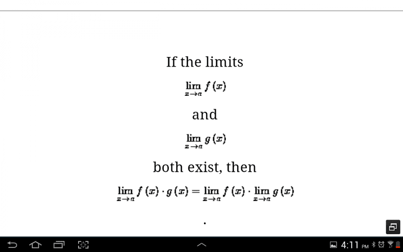

Isn't that a limit law though?
You are doing something completely different from that law. Not only are you not computing ##\Delta(g(x) h(x))## correctly, you are also introducing an arbitrary extra ##\Delta x## in the denominator.
Also, you should stop attaching images like these. They are going to be impossible to read on most mobile devices and impossible to quote properly. There is a tutorial on how to write proper forum maths here: https://www.physicsforums.com/help/latexhelp/
I understand that I put in an extra Δx. But how is Δ(g(x)h(x)) beung computed incorrectly?
You are assuming ##\Delta(g(x)h(x)) = (\Delta g(x))(\Delta h(x))## to leading order in ##\Delta x##:
