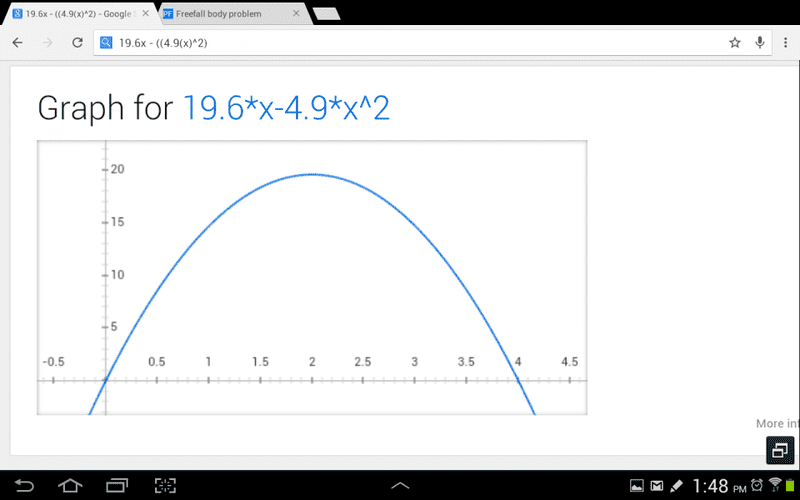

A ball is thrown vertically upward with an initial speed of 19.6 m/s from the top of a building 44.1 m tall. Assuming that there is no air resistance.
a.) At what two times is the ball 10.0 m above its starting point?
b.) What is the position of the ball at t = 5.00 s?
c.) How long will it take the ball to strike the ground?
d.) What is the velocity of the ball when it strikes the ground?
Kinematics Equation/Projectile Equations
a.) First I took 10 m as my delta Y then 19.6 m/s as may initial velocity to get the time
10 m = (19.6 m/s)(t) - (1/2)(9.8m/s^2)(t)^2
t = 3.3997 s
b.) First I took the time to get to the max height which is (19.6 m/s)/(9.8 m/s^2) = 2 s as my Tmax
then I compute for the Ymax which is Y=(19.6 m/s)(2 s) - (1/2)(9.8 m/s^2)(2 s)^2
Ymax = 19.6 m
then I added 19.6 m + 44.1 m = 63.7 m to get the height from base of the building to the max height of the projectile
then next is to get the position of the ball at 5 s
Y=(19.6 m/s)(5 s) - (1/2)(9.8 m/s^2)(2 s)^2
Y=-24.5 m
Then I substract 63.7 m - 24.5 m = 39.2 m
c.) 63.7 m = (19.6 m/s)(t) - (1/2)(9.8)(t)^2
but then it can't be solved sooooo I think I got wrong somewhere
pls help thank you.

So for part A, you should have two times. The ball rises AND falls. I think the time you have is when the ball hits 10m as it is falling.
Heres a graph of displacement as a function of time for the situation:
For part B, I think all you need to is plug 5 in for t and solve. There is no need to calculate the maximum height.
Your new equation for part C is correct.

Not quite. If you look at the graph, the ball appears to be at y=10 at two points. One of them is the you discovered: 3.399. You have to find the other one which appears to be at around 0.6 seconds.
Think of it this way. You toss the ball up. At .6 seconds it reaches 10 m. It keeps going higher and starts to fall. On its descent it reaches the same point once again. But more time has passed. It is now 3.399 seconds since you threw it.
I suggest you factor the equation as a quadratic or use the quadratic formula.
