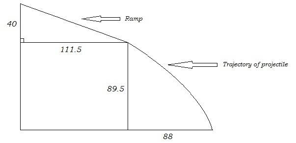

Basically I did my experiment based in projectile motion, one of the trial give me 88cm out of the ramp, like distance traveled, then the total horizontal length of the ramp was 111.5cm and the height 40cm, also the vertical height of the ramp before touching ground was 89.5, I'm pretty stuck looking for displacement and time, if you can help me I will be kindly greatful(Sun)

Just so we understand correctly, I am assuming a projectile, likely a small ball, is rolled down a ramp, and then free falls 89.5 cm down to the ground, as in the following diagram, where the measures are in cm:
The projectile hits the ground a horizontal distance of 88 cm from the bottom end of the ramp. Is this correct?

yes that is exactly what I meant, hehehe you got it, but how I'm suppose to get the displacement and time?
I would begin with the parametric equations of motion:
(1) $$x=v_0\cos(\theta)t$$
(2) $$y=-\frac{g}{2}t^2+v_0\sin(\theta)t$$
To eliminate the parameter $t$, we solve (1) for $t$ and substitute into (2) to get:
(3) $$y=\tan(\theta)x-\frac{g}{2v_0^2\cos^2(\theta)}x^2$$
Now we have the height $y$ of the ball as a function of the initial velocity $v_0$, the launch angle $\theta$ and the horizontal displacement $x$. Be sure to convert all of the measures to meters, since $g$ uses the meter in its units.

Do you know how to find the velocity of the projectile just as it leaves the ramp?
I would use the equation:
$$v_0=\sqrt{2a\ell}$$
where:
$\ell$ is the length of the inclined portion of the ramp, i.e., the distance through which the projectile is accelerated before free falling. Use the Pythagorean theorem to find it, since it is the hypotenuse of a right triangle and you know the leg lengths.
$a$ is the acceleration of the projectile as it moves down the ramp. This will be a function of $g$, the acceleration due to gravity, the vertical component of the ramp's inclination, and the length of the ramp $\ell$, hence you should verify that we find:
$$a=g\frac{0.40}{\ell}$$
Once you have $v_0$, and $\theta$ (the negative of the angle of inclination of the ramp), you may use (1) and(2) to parametrically describe the trajectory of the projectile.

Oh, okay, so the hypotenuse is 111.5 cm, then the side opposite the angle is 40 cm. Use the Pythagorean theorem to get the side adjacent to the angle, we'll call it $x$, and we may write:
$$x^2+40^2=111.5^2$$
Now solve for $x$, and then:
$$\cos(\alpha)=\frac{2x}{223}$$
As far as the angle of inclination $\alpha$ of the ramp, I would use:
$$\alpha=\sin^{-1}\left(\frac{80}{223} \right)$$
