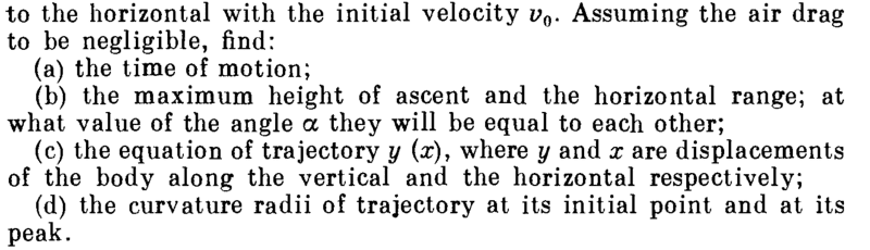

Printed problem statement numbered 1.29: A body is thrown from the surface of the Earth at an angle α
Printed problem text, part of a projectile motion question asking for the time of motion, maximum height and range, the trajectory equation y(x), and curvature radii at the initial point and peak.
For part (d),
The curvature radius of trajectory at its
1) initial point = horizontal range/2 =( v02 sin (2α))/2g
2) peak = height of ascent/2 = ( v0 sinα)2 /2g
Is this correct?
In this problem, the time of ascent is equal to the time of descent.
Is there anyway to find it out without calculating the time of ascent and the time of descent ?

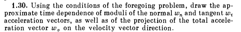

Printed problem 1.30: Using the conditions of the foregoing problem, draw the approximate time dependence of moduli of the normal w_n and tangent w_τ acceleration vectors, and of the projection of the total acceleration vector w_v on the velocity vector direction.
vy (t) = v0 sinα - gt
vx (t) = v0 cosα
tan (θ) = vy (t) / vx (t) = tan α - gt/(v0 cosα)
a = g(- ## \hat y##)
wτ = g sinθ (- ## \hat θ##),
wn = g cosθ (- ## \hat r##)
Is this correct so far?

You can put (vertical) displacement=0 in the y-displacement equation. It's a quadratic equation.

This will give me the total time of motion and this, too, I will have to calculate.
I want to show :
time of ascent = time of descent without doing calculation, just on the basis of physical interpretation of the problem
Is this possible?

Yes.
Your x component of velocity doesn't change. And during ascent, you start with non-zero velocity and end up with zero velocity while during descent, you start with zero velocity and end up with the initial velocity. Displacement is same in both the cases and the motion is under the influence of the same force, i.e. gravity.
The time a body takes to go up to a certain height is equal to the time it takes to free fall from the same height.
You need to consider the centripetal forces responsible for the curvature here.
Which force is responsible for the curvature when the body is at the peak? How much is that force?
When the body is at the initial point,
mv02 /Ri = mg cosα
Ri = v02/g cosα
When the body is at the peak,
m(v0 cosα)2 /Rp = mg
Rp = (v0 cosα)2/g
Is this correct?
mv02 /Ri = mg cosα
Ri = v02/g cosα
Rp = (v0 cosα)2/g
Is this correct?
Yes.
Pushoam said:
a = g(- ^yy^ \hat y)
wτ = g sinθ (- ^θθ^ \hat θ),
wn = g cosθ (- ^rr^ \hat r)
Correct. So now you can draw the approximate plot of the tangential and normal acceleration.
You know their values at t=0, t=T/2 and t=T.
