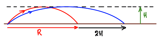

A cannon ball fired like a projectile has a range ##R## on a still day. On a windy day, the wind blows horizontally at a constant speed. The ball fired with the same speed at the same angle relative to the cannon is found to have a range of ##R+2H## on the windy day, where ##H## is the maximum vertical height attained by the ball. How is the wind velocity related to the initial velocity of the ball relative to the cannon?
(1) Range of a projectile : ##R = v_{0x} T## where ##v_{0x}## is the initial velocity in the ##x## direction and ##T## is the total time of flight. (This range increases due to wind, implying that ##v_{0x}' = v_{0x}+v_w## where ##v_w## is the wind velocity. Crucially, the time(s) of flight remain the same).
(2) The time of flight ##T = \dfrac{2v_{0y}}{g}##, which remains unaltered because the initial ##\underline{\text{vertical}}## component of the projectile velocity, ##v_{0y}## remains the same.
(3) The maximum height of the projectile ##H = \frac{v^2_{0y}}{2g}##, which remains the same for the same reason as (2) above.
Let me start be making a small sketch of the problem, shown to the right.
If the range of the projectile on a still day ##R = v_{0x}T##, then on the windy day the range becomes ##R+2H = v'_{0x}T = (v_{0x}+v_w) T##.
Since the maximum height attained by the projectile ##H = \dfrac{v_{0y}^2}{2g}##, the above equation simplifies to : ##\cancel{v_{0x}T} + \dfrac{v_{0y}^2}{g} = (\cancel{v_{0x}}+v_w) T##. But since the time of flight ##T = \dfrac{2v_{0y}}{g}##, we have ##\dfrac{v_{0y}^\cancel{2}}{\cancel{g}} = \dfrac{2\cancel{v_{0y}}v_w}{\cancel{g}}\Rightarrow \boxed{v_w = \dfrac{v_{0y}}{2}}##.
A hint or help would be welcome if I am mistaken somewhere.

What you've done looks right to me. This book answer is the same, but expressed in terms of ##H##, rather than ##v_{0y}##.
