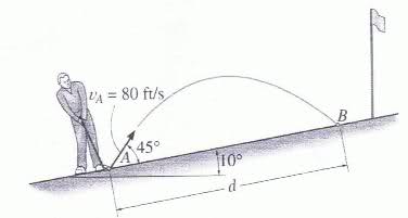

Diagram of a golfer at point A hitting a ball with speed vA = 80 ft/s at 45° above the horizontal, on a slope inclined 10° upward; the ball lands at B near a flag, distance d measured along the slope.
There is the question I am having trouble with. All the data is given in the image. I am to find "d". The slope being on an angle is what is throwing me off. It would be simple enough if the ground was perfectly horizontal, but I am not sure how to handle the 10 degree incline.
My first thought was to make it as the golf ball was hit horizontally and at an angle of 55 degrees. I am not sure how to figure out the distance "d" though.
Any help would be greatly appriciated
s=volt + 1/2 at^2
v=vo + at
V^2=vo^2 + 2as
I am not sure where to start.
Find the horizontal speed. Determine the height at B. Plug that time into your equation for height: [itex]h = v_yt - .5gt^2[/itex] to find the time of flight. Put that value of t into your equation for horizontal speed.

Thanks for the reply.
I have the horizontal speed as 80cos55 = 45.89ft/s
I am unsure of how to calculate the height at which the ball hits the ground. Could someone shed some light as to how I would go about this.
Thanks in advance.
The height divided by the horizontal distance traveled (vxt) is tan(10).
This equation for h, combined with [itex]h = v_{0y}t -\frac{1}{2}gt^2[/itex] gives you two equations and two unknowns. So you can solve for t.
