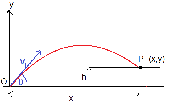

I won't be able to provide the specific problem (in terms of numbers). I was hoping for a conceptual solution.
A ball is thrown. From its initial location, it lands on a shelf a given distance away. I am given the distance to the shelf, the height of the shelf, and the initial angle of incidence.
I am required to find the final displacement in the x direction, as well as the initial velocity of the projectile.

I'd like to clear up something before helping out with the rest of the question. You said the distance between the thrower and the shelf is given but you're asked to find the displacement in the x-axis? Wouldn't those two be the same or is it on a different plane?
Actually, the projectile flies over the shelf, landing some distance beyond it (but still on it!). The shelf is... erm... infinite in length... haha.

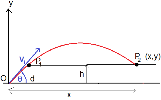

You can solve for the initial velocity Vi if the horizontal coordinate of the landing point is given, using the equation of the trajectory. The distance of the shelf is irrelevant. So you need to clarify, what does it mean that the ball lands on a shelf a given distance away. If it is the distance between points O and P, you can get X from Pythagoras' law.

That was a good post and the diagram looks similar to what I drew. Yes, I am looking for the total x displacement, from O to P.
However, the landing coordinate is not given...
The question does mention that the projectile makes a near miss with the corner of the shelf... is this relevant or helpful?Really I'm stuck because with the given information I see no useful equation for getting the answer.

Yes, it is very relevant and helpful, as you know both the distance and the height of the corner of the shelf, that is, the coordinates of the point P1.

To be honest, I didn't know what to make of the near miss hint, as it seemed like white noise due to the fact that it does not hit the corner, and therefore the point. I suppose the question maker meant it to be assumed that the miss was arbitrarily close.
