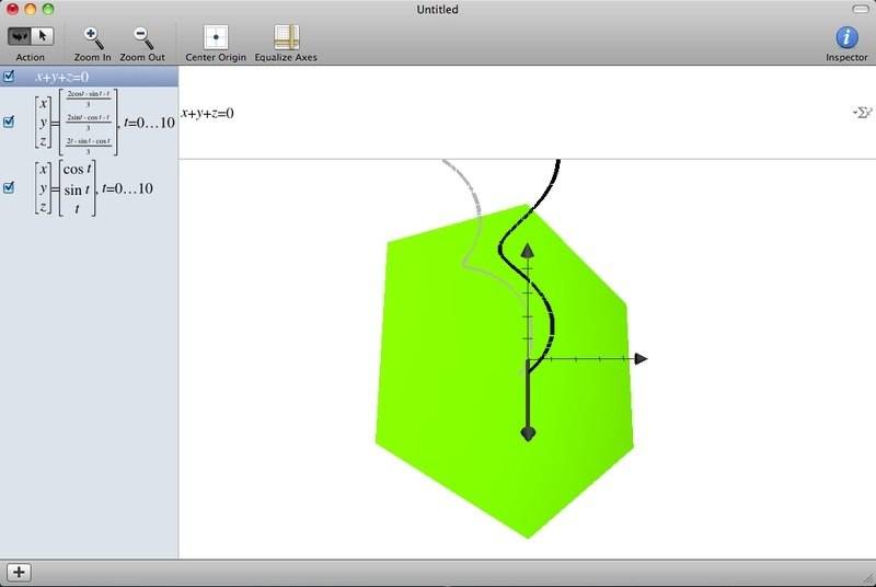

So I've encountered many "what is the projection of the space curve C onto the xy-plane?" type of problems, but I recently came across a "what is the project of the space curve C onto this specific plane P?" type of question and wasn't sure how to proceed. The internet didn't yield me answers so I haven't made much headway. The problem and my attempt at a solution is outlined below:
Compute the projection of the curve \vec{\mathbf{r}}(t) = \left\langle \mathrm{cos\:}t, \mathrm{sin\:}t, t \right\rangle onto the plane x + y + z = 0.
I'm having trouble come up with an equation. I've tried drawing the relevant xy-, yz-, and xz-plane projections and seeing where the curves intersect, but I know that these intersection points do NOT necessarily correspond to the projection of the given curve onto the given plane.
See reasoning above. I really don't know how to do this for a non-standard plane and so I'm completely lost as to how to make headway. I haven't been able to find relevant information on the internet either through a similar problem for some reason.
Can anybody help me out? If so, is there a way to do this for ANY plane P and ANY space curve \vec{\mathbf{r}}(t)? I feel like there should be yet Stewart's Multivariable Calculus yields nothing (at least the 5th edition doesn't) in this area. Thank you in advance.

Okay just for completion I want to post that I officially figured it out.
Using the change of basis, I ended up rewriting the old x,y,z in terms of the new ones, and deriving an equation for this "flattened" helix on the plane:
\left( \begin{array}{c}<br /> \hat{x} \\<br /> \hat{y} \\<br /> \hat{z} \end{array} \right) =<br /> \left( \begin{array}{c}<br /> \frac{2\mathrm{cos\:}t - \mathrm{sin\:}t - t}{3} \\<br /> \frac{2\mathrm{sin\:}t - \mathrm{cos\:}t - t}{3} \\<br /> \frac{2t - \mathrm{sin\:}t - \mathrm{cos\:}t}{3} \end{array} \right)
Graphing this in Mac's Grapher program or an equivalent software produces the attached diagram, which is what we're going for. Thanks tiny-tim for helping me visualize/understand the process!

You can do it without changing basis vectors. Let's say you have a point ##P_0## on the plane and a unit normal ##\hat n## pointing to the side that ##P_0## is on. Let your curve be ##\vec r(t)##. Then the projection curve is ##\vec p(t)=\vec r(t) - (\vec r(t)-P_0\cdot \hat n)\hat n##.
I can give you more details later but have to run now.
Yep I just used that method after the orthonormal one. In the end it's kind of the same thing because you'll end up getting v – (n•v/n•n) n, which is like the Gram-Schmidt process for creating an orthonormal basis. Analogous procedures! Geometric versus algebraic arguments I suppose.
