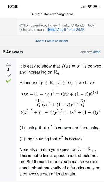

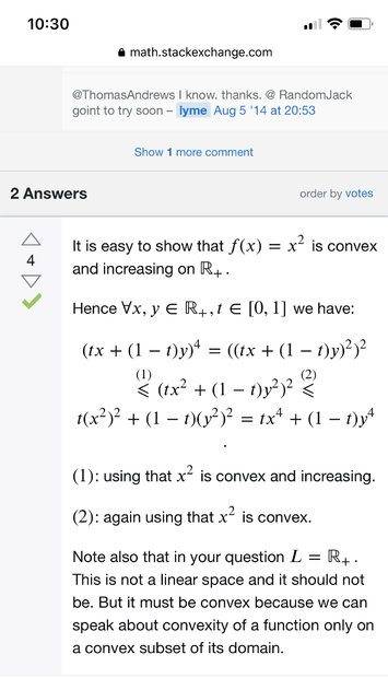

I’m trying to follow this proof of ##x^4## being strictly convex but I don’t understand how they got rid of the cross terms with step ##\left( 2 \right)##

I’m confused. To me that is precisely the reason we can’t get rid of them in the end. Let me be more explicit.
##\left\| \lambda \vec{x} + \left( 1 - \lambda \right)\vec{y} \right\|^4 = \left( \left\| \lambda \vec{x} \left( 1 - \lambda \right) \vec{y} \right\|^2 \right)^2 \leq \left( \lambda \left\| \vec{x}\right\|^2 + \left(1 - \lambda \right) \left\| \vec{y} \right\|^2 \right)^2##
Where I've used the fact that ##\left\| \vec{x} \right\|^2 ## is convex to get to the ##/leq## inequality
To me the only thing I can do now is "foil it out"
## = \lambda^2 \left\| \vec{x} \right\|^4 + 2 \lambda \left( 1 - \lambda \right) \left\| \vec{x} \right\|^2 \left\| \vec{y} \right\|^2 + \left( 1 - \lambda \right)^2 \left\| \vec{y} \right\|^4##
We know that both ##\lambda , \left(1 - \lambda \right) \lt 1 \Rightarrow \lambda^2 , \left( 1 - \lambda \right)^2 \lt \lambda, 1 - \lambda ##
## \lt \lambda \left\| \vec{x} \right\|^4 + 2 \lambda \left( 1 - \lambda \right) \left\| \vec{x} \right\|^2 \left\| \vec{y} \right\|^2 + \left( 1 - \lambda \right) \left\| \vec{y} \right\|^4##
So all in all
##\left\| \lambda \vec{x} + \left( 1 - \lambda \right) \right\|^4 \lt \lambda \left\| \vec{x} \right\|^4 + 2 \lambda \left( 1 - \lambda \right) \left\| \vec{x} \right\|^2 \left\| \vec{y} \right\|^2 + \left( 1 - \lambda \right) \left\| \vec{y} \right\|^4 ##
Don't know how to get rid of the middle cross term ##2 \lambda \left( 1 - \lambda \right) \left\| \vec{x} \right\|^2 \left\| \vec{y} \right\|^2##
You're right. They are simply applying the convex property of ##x^2## twice. There's no expansion needed.
PS It's cometimes easier to generalise things. Suppose ##f: \mathbb R_+ \rightarrow \mathbb R_+## is convex and increasing, then ##f \circ f## is convex and increasing:
Let ##t \in [0, 1]## and ##x, y \in \mathbb R_+##. We have:
$$f(tx + (1-t)y) \le tf(x) + (1-t)f(y) \ \ (\text{as} \ f \ \text{is convex})$$$$\Rightarrow \ f[f(tx + (1-t)y)] \le f[tf(x) + (1-t)f(y)] \ \ (\text{as} \ f \ \text{is increasing})$$ $$\le tf[f(x)] + (1-t)f[f(y)] \ \ (\text{as} \ f \ \text{is convex and} \ f(x), f(y) \in \mathbb R_+)$$$$\therefore f \circ f(tx + (1-t)y) \le tf \circ f(x) + (1-t)f \circ f(y)$$$$\therefore f \circ f \ \text{is convex}$$It's easy to show that ##f \circ f## in increasing, although not a bad exercise, in fact.
I actually see it now. Wow this has confused me for several days.All we needed to do was make a change of variables
##\left\| \vec{x} \right\|^2 \mapsto X \in \mathbb{R} ##
##\left\| \vec{y} \right\|^2 \mapsto Y \in \mathbb{R} ##
and repeat the argument and replace ##X## and ##Y## at the end.
Can't believe I didn't see it until now. Thank you for your help.
