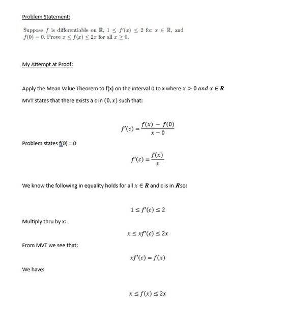

Suppose f is diff. on R, 1<=f'(x)<=2 for x in R and f(0)=0. Prove x<=f(x)<=2x for all x > 0
MVT
See my image for my attempt at solving this problem. My approach varies significantly from the solution I have for this problem and I wanted to get feedback on if what I did is correct of where I went wrong. thanks.

Your proof looks ok to me. I wonder what the other proof is. If something is true, there can be multiple ways to prove it. Often, a particular proof is desired to teach the use of specific theorems or facts.

Your argument is correct, but it is easier to note that for [itex]x > 0[/itex], [tex] 1 \leq f'(x) \leq 2 \Rightarrow \int_0^x \,dt \leq \int_0^x f'(t)\,dt \leq \int_0^x 2\,dt[/tex] and hence [tex] x \leq f(x) - f(0) \leq 2x.[/tex]

For the record, the book's argument is that [itex]f(x) - x[/itex] has positive derivative and is therefore increasing; since [itex]f(0) - 0 = 0[/itex] it follows that [itex]f(x) - x \geq 0[/itex] on [itex][0, \infty)[/itex]. Similarly [itex]2x - f(x)[/itex] is increasing and equal to zero at [itex]x = 0[/itex]. That positive derivative implies increasing is proven in an earlier excersice by use of the mean value theorem.
I think your argument back in post #1 is the simplest most direct possible proof. I.e. you show that result follows from just substituting into the statement of the MVT. To me nothing could be easier than that.

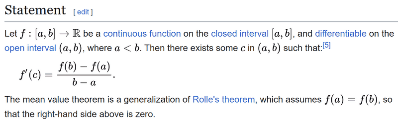

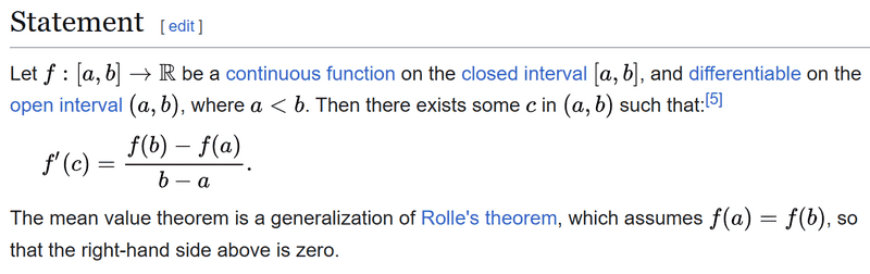

renormalize said:
Wikipedia disagrees: it states that the function must also be continuous (https://en.wikipedia.org/wiki/Mean_value_theorem):
Any differentiable function is automatically continuous, so that's not an additional assumption. The question was whether ##f'## must also be continuous (it doesn't need to be).
The point of explicitly mentioning continuity in the wikipedia article is that the function doesn't need to be differentiable at the endpoints of the interval, as long as it's continuous there and differentiable on the interior, but being differentiable everywhere is still enough.
The important point is that a function could be differentiable on ##(a,b)## but not continuous at the end points. And for such a function the MVT may not apply.
In other words, differentiablity on ##(a,b)## implies continuity on ##(a,b)## but not necessarily continuity on ##[a,b]##.
As @Infrared has pointed put, the MVT does not require that the derivative is integrable. So, the proof using the integral is not valid.
