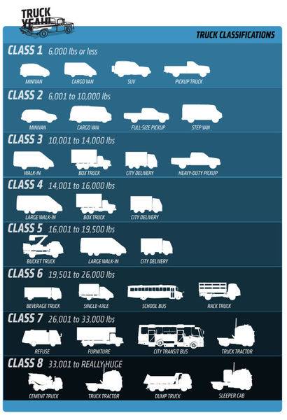

I'm in Canada and a ton has always been 2000 lb around here. But we're with the SI system as well, so this is not a usual unit for us nowadays (unless we have to do business with our neighbor).
As for truck classification, it is done in pounds, so no problem there:
