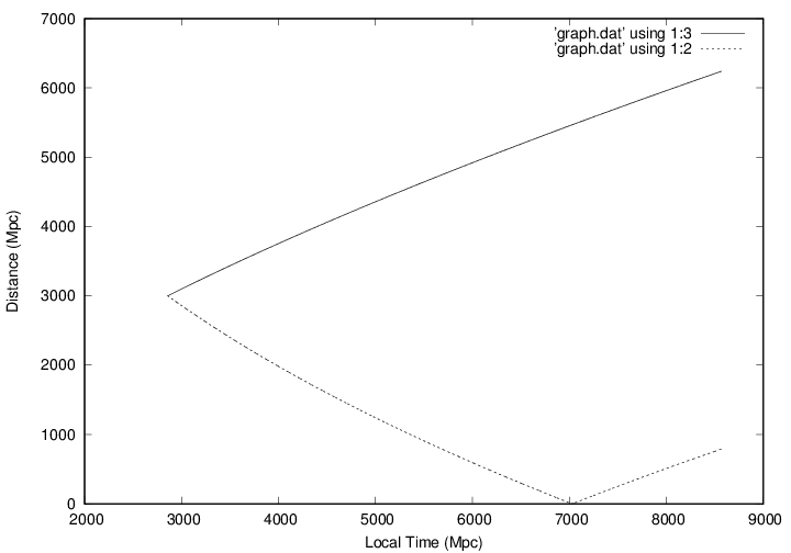

I am working on a project which consists in calculating numerically the trajectory of a light ray in the Friedmann-Lemaitre metric with the case "k = 0" (euclidean space) and zero cosmological constant.
The light ray is emitted by a source galaxy at instant ##t_{0}=\dfrac{2}{3H_{0}}## (today) and at a distance taken as a parameter (which I think, is called "comoving distance") and is equal to :$$d_{comoving}=R_{0}\,r_{0}$$
with ##R_{0}## the scale factor of today and ##r_{0}## the radial coordinate.
In my program, I have taken an initial value of ##3000 Mpc## for the physical distance of light ray emitted (##d_{comoving}=3000 Mpc##).
Equations of propagation of this light ray are deduced from the following equations :
$$\dfrac{\text{d}^2 u^{i}}{\text{d}s^2}+\Gamma^{i}_{jk}\,\dfrac{\text{d}u^{j}}{\text{d}s}\,\dfrac{\text{d}u^{k}}{\text{d}s}=0
So, I get finally a differential system that I numerically solve (with ##(t,r,\theta,\phi)## the values of variables to find).
For example, the time equation of this system is :
$$\dfrac{\text{d}^{2}ct}{\text{d}s^{2}} =
-\dfrac{2}{3}\,R_{0}^{2}\,\bigg(\dfrac{3\,H_{0}}{2\,c}\bigg)^{4/3}\,(ct)^{1/3}\,\bigg(\bigg(\dfrac{\text{d}r}{\text{d}s}\bigg)^{2}+r^2\,\bigg(\dfrac{\text{d}\,\theta}{\text{d}s}\bigg)^{2}+r^{2}\,\text{sin}^{2}(\theta)\,\bigg(\dfrac{\text{d}\phi}{\text{d}s}\bigg)^{2}\bigg)$$
by taking for scale factor the following analytical formula :
$$R(t)=R_{0}\bigg(\dfrac{3H_{0}t}{2}\bigg)^{2/3}$$
and with ##s## an affine parameter.
Actually, I have taken ##R_{0}=1## in my code, thinking this would make results easier to handle.
Below on the image, the results that I have got :
On ##Ox## axis is represented the local time of our galaxy. on ##Oy## the distance betweeen us and the source galaxy emitting.
Solid line represents the trajectory of the source galaxy (which is moving away from us with a distance : $$d_{source}(t)=R(t)r_{0}$$ with ##t>t_{0}##).
Dashed line represents the trajectory of the light ray from source galaxy to our galaxy.
As you can see, light ray reaches our galaxy at a cosmic time about ##7## Giga parsec/c, i.e ##21## Billion years (what is very high, I admit but the problem is not about this). Don't pay attention about the bounce, it is just that I impose a positive value for radial coordinate ##r##.
What I would like to know is if I have to multiply or not the set of all numerical values of radial coordinate (##(r_{i})##) by the scale factor corresponding to time ##t=t_{i}## to get the physical distance of the light ray relatively to our galaxy.
On the above image, I didn't multiply the radial coordinates values ##(r_{i})## by :
$$R(t_{i})/R_{0}=\bigg(\dfrac{3H_{0}t_{i}}{2}\bigg)^{2/3}$$

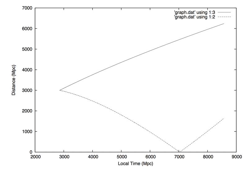

If I multiply each radial coordinate ##r_{i}## by ##R(t_{i})/R_{0}##, I get the following results :
As you can see in comparison with the first image, the form of the trajectory curve is not the same, an in the same time, the convexity is not also the same : on the first results (without multiplying by ##R(t_{i})/R_{0}##), the curve of trajectory is convex whereas with multiplying, the curve of trajectory is concave :
From this difference of convexity between the 2 results, can we make a choice and conclude about the right method to apply, i.e multiply or not by ##R(t_{i})/R_{0}## each numerical value of radial coordinate solved from the differential system ?
Any help or remark is welcome,
Regards

Hi fab13. In a euclidean space with both x and y-axis based on time (or distance based on time and c) and assuming a constant c, wouldn't you expect the trajectory of an emitted photon to be in a straight line from its emission source to the observer? Especially as the source is moving away from the observer in your example and you mention no other intervening mass.
Øyvind Grøn in "Space geometry in rotating reference frames: A historical appraisal" refers to such a plot as "optical appearance". i.e.
http://areeweb.polito.it/ricerca/relgrav/solciclos/gron_d.pdf
The result is shown in Fig. 9. Part C of the figure shows the “optical appearance” of a rolling ring, i.e. the positions of emission events where the emitted light from all the points arrives at a fixed point of time at the point of contact of the ring with the ground. In other words it is the position of the points when they emitted light that arrives at a camera on the ground just as the ring passes the camera.
With specific reference to your problem, what is not shown in part C are the straight line photon paths from each of the emission points to the camera (point 1), which on a plot with both the x and y-axis based on time (or distance based on time and c) equal the emitted photons actual travel times and distances.

you can see below a figure illustrating what my code is computing :
http://i.imgur.com/pzLJXrR.png
On the left, you can see the source galaxy which emits a light ray, and on the right, the time axis of our galaxy. Between them, you can see the trajectory of the light ray which is curved (not by mass but I guess that the Friedmann-LeMaitre metric bends the light, i.e on very large distances and scales).
You can also notice that Hubble expansion makes increase the distance between the source galaxy and our galaxy (you can draw an horizontal line for a given ##ct_{i}## for our local time and the value of proper distance of source galaxy corresponding to ##ct_{i}## value).
But my issue is that I don't know if I have to multiply the coordinates of light ray (noted by the set of values ##(r_{i})##) by :
Which convexity is expected (convex or concave ? ) for a light ray trajectory in this metric Friedman-LeMaitre (in case ##k=0## and ##\Lambda=0##) ?
PS: for admin, I didn't get to put the above image in tag IMG, if you could fix it and include directly this image in my post ...
Thanks
