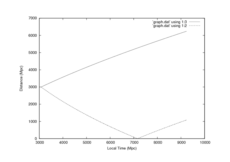

If i take [tex]\frac{d\,\phi}{ds} = \frac{d\,\theta}{ds} = 0[/tex], ie if i consider only radial trajectories, i get the figure 1 in attachment where i plot the Distance "r" as a function of Local time "ct" expressed in Megaparsec. i took to get this figure :
[tex]\bigg(\frac{d\,r}{ds}\bigg)_{0} = -1[/tex]
[tex]\bigg(\frac{d\,\theta}{ds}\bigg)_{0} = 0[/tex]
[tex]\bigg(\frac{d\,\phi}{ds}\bigg)_{0} = 0[/tex]
[tex]r{0} = 3000 Mpc[/tex]
and
[tex]R_{0} = 1[/tex]​
The dotted line represents the trajectory of light ray and the solid line represents the trajectory of the galaxy where light is emitted.

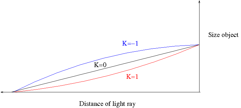

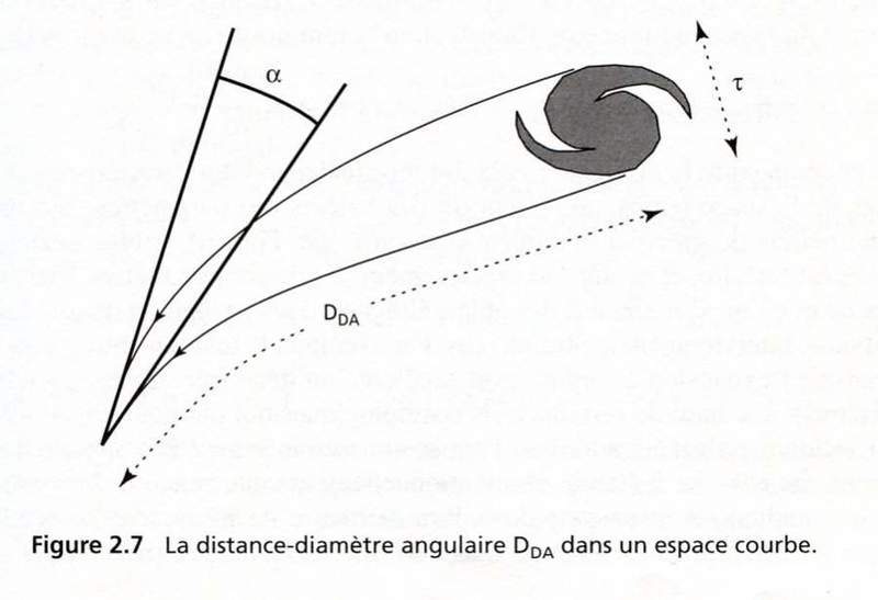

the problem I encounter is when I'm looking for the propagation of two rays and to compare the actual angular size of the object and the angular size that we observe. This is represented on figure 2 in attachment. I don't know how to make converge the two rays when they arrive in our galaxy. I think that "r" and "theta" should vary simultaneously but what initial conditions should I take to it ?
We can see on figure 3 in attachment the case where curvature k=0. It's possible to have "theta" constant and "r" which decreases but in the two others cases, "theta" and "r" vary in same time. I hope you understand my problem.

The way that this is sometimes addressed in general is via the Dyer-Roder equation, which looks at a bundle of light rays and works out how that bundle get converged or sheared as it passes through the Universe. However in the case of a smooth universe (as you are using) this becomes much simpler to compute, and there is a relatively simple single integral to be performed, which tells you this 'Angular Diameter Distance'.
There is an excellent summary of this and other distance measures available from ArXiv http://arxiv.org/abs/astro-ph/9905116" . Every cosmology grad student should have this paper handy at all times (and most that I know do...).
