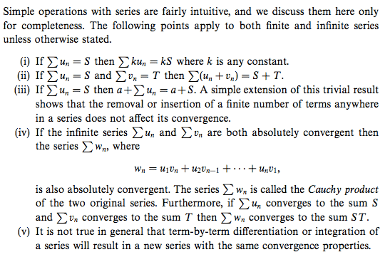

Do (i), (ii) and (iii) apply to conditionally convergent series as well? I feel like they don't. But the book seems to say that they do because it doesn't "state otherwise".
Why do you feel so, do you have a counterexample?
Is there any reordering involved in (i) to (iii)?
Yes there is. For (ii), it says ##u_1+u_2+...+v_1+v_2+...=u_1+v_1+u_2+v_2+...##.
There is no reordering in (iii). So we are left to prove that (ii) is true for conditionally convergent series.
If (ii) is true and if (i) is true for ##k=-1##, then (i) is true for all ##k##. Consider ##v_n=\frac{1}{2}u_n##, then using (ii), ##T=S-T##, so ##T=\frac{1}{2}S##. Similarly, we can prove (i) is true for all rational ##k##. Next, we use squeeze theorem to prove that (i) is true for all irrational ##k## too.
The first thing is not well-defined, and never appears in the problem.
While that is correct, it is way more complicated than necessary. Also, I would think most proofs of the squeeze theorem use one of those properties in some way, making the argument circular.
Is ##(u_1+u_2+...)+(v_1+v_2+...)=(u_1+v_1)+(u_2+v_2)+...## well defined? It says summing up all the ##u##'s and separately all the ##v##'s and then adding up the two sums is equal to summing up all the ##(u+v)##'s. So there is a rearrangement.
That is better, if the "..." are understood as limits.
There is still no rearrangement of the order of the elements in the series, e. g. u5 is always added after u4.
But the order we do the sum is different in the RHS from that in the LHS. Isn't this generally not allowed for conditionally convergent series?
As I said, try to find a counterexample. And when you see that every attempt fails, you'll get some insight why the rule is also true for condionally convergent series, and then you can prove it.
Note: conditional doesn't mean every reordering has a different limit. Only some of them. And we still don't reorder within the series here.

Happiness said:
Since (i) is true for rational ##k_1##,
##\lim_{k_1\rightarrow k}\Sigma k_1u_n=kS##. (And similarly true for ##k_2##.)
How does this step work? You would have to show that you can take out the factor (which is directly what you want to prove) or that limit and sum commute (which is not trivial, and in general false).
Anyway, you are making this way more complicated by going that route. You can directly prove it via the definition of a limit.
##\lim_{k_1\rightarrow k}\Sigma k_1u_n=\lim_{k_1\rightarrow k}k_1\Sigma u_n##, since (i) is true for rational ##k_1##
##=k\Sigma u_n=kS##
I can't prove it directly.
Since ##\lim_{n\rightarrow\infty}\Sigma_{r=1}^nu_r=S##,
##\forall\epsilon>0, \exists N:\,\forall n>N, |\Sigma_{r=1}^nu_r-S|<\epsilon##
##|k|\,|\Sigma_{r=1}^nu_r-S|<|k|\epsilon##
##|k\,\Sigma_{r=1}^nu_r-kS|<|k|\epsilon##
but we want to show that
##|\Sigma_{r=1}^nku_r-kS|<|k|\epsilon,\,\forall n>N##.
This is true if ##k\,\Sigma_{r=1}^nu_r=\Sigma_{r=1}^nku_r,\,\forall n>N## including ##n=\infty##. But this is precisely what we want to prove.
##=k\Sigma u_n=kS##
That part works, but how do you prove it is equal to ##\lim_{n \to \infty} \sum_{i=0}^n k u_i##?
You can. For a finite sum, ##k \sum u_r = \sum k u_r## is trivial (distributive law), and you don't need it for "n=∞" because that never appears in the proof.
##\sum_{i=0}^n k_1u_i\leq\sum_{i=0}^n k u_i\leq\sum_{i=0}^n k_2u_i##
By squeeze theorem,
##\lim_{n \to \infty} \sum_{i=0}^n k u_i=kS##
##\forall n>N## means we only need to consider finite values of ##n##?
n is a natural number. Every natural number is finite.
