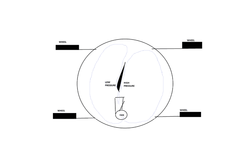

Whicle has 4 wheels, inside is oval closed room with fan that blow inside air to the wing. Wing produce difference in static pressure in direction of travel.
Will vehicle move forward or not?
If I look just at pressure difference at wing, vehicle will move forward but I know from Newton 3 law, you can't move object with "internal forces", just like you can't move car forward if you you are on seat and push front window with your legs..
If vehicle will not move how explain this with pressure distribution?
Exactly. So that means you must look beyond just the pressure difference at the wing. Where else do you think you should look?
At the room walls and at every object inside the room..
Interesting how nature distribute all these surface pressures in such way that resultant force is allways zero.
Newton 3 law is in same time so simple and so brilliant.
Exactly, yes.

Is photon drive one way to achieve propulsion with closed system, because photons don't have mass?
If I point powerful laser to the back, will vehicle move forward?
They carry momentum. If they escape the system they carry away momentum and the system moves but is not closed. If they don't escape, the system doesn't move.
