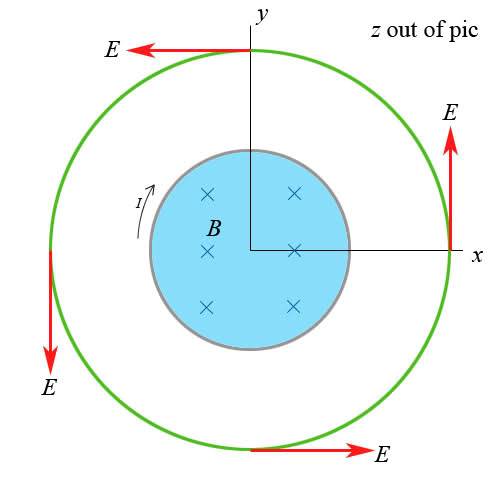

sorry :X hahaha okay so its a
uniform magnetic field pointing into the page, decreasing at some rate. its actually a circular magnetic field with some radius R and the proton is in the magnetic field.
the question asks "when it is released from rest, what happens to the proton?"

Consider the following picture:
(I hope this corresponds to what you have in mind)
Let's say the magnetic field B (blue region, going into the picture, -z direction) is a magnetic field induced by the current I in a solenoid (the gray circle around the blue region).
Let's say this magnetic field is increasing.
Due to the increase in magnetic field, an electric field E (shown with red arrows and green circle) will be created.Is this what you mean?Now consider a proton on the negative x-axis for example (in the blue region, not in the origin).
Try to find the direction of the lorentz force using the formula:
\vec{F} = q( \vec{E} + \vec{v} \times \vec{B} )
it absolutely corresponds to what i have in mind. except the magnetic field is decreasing its exactly what i have in mind
okay so F=qE i have as going in the negative y direction
and as for the v x b, with its velocty vector in the negative y direction and the b field going into the page...i have the cross product going to the right along the positive x axis.
therefore if we add the vectors it would...go diagnolly down! the positive x-axis and the negative x axis!
? how was that? :D
So far so good I think. However I think if the B-field was decreasing the E-field would turn the other way.
What you say however is only valid if you describe the proton starting from rest on the negative x-axis.
Can you describe the path the proton makes after starting from rest? Does it keep going in a circle, maybe an ellipse, parabola??
Actually, I think this depends on the values of the B and E field. Since you are (vector)adding the E and vxB vectors their size matters. If E was VERY large compared to vxB than the motion was effectively downward only.
