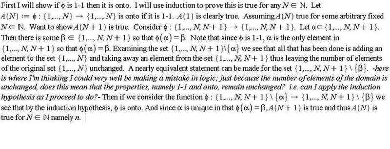

I used induction but I have a strong suspicion I made a logical error so let me start by saying that in truth, I don't really know how to approach this problem because we are given so little. I can't say that {1,...,n} is a finite set so there has to be a 1-1 function from {1,...,n} onto it because I can't say that the set is "finite" simply by looking. Actually, I can say that, and it is finite, but in the proof, I certainly cannot simply say this. Also, proving both parts of thsi has been proving to be a challenge. Proving that 1-1 implies it is onto seems easier than proving the function is onto implies it is 1-1. I'm just sort of lost and frustrated. But here's my attempt in it's entirety:
(it's the attached image, I typed it up on MAPLE)
Also, I have a little scribbled out for proving that if the function is onto then it is 1-1 but I didn't get as far and any help there would be appreciated.

Your induction looks pretty good, but you juggle your words a bit wishy washily so it's not clear what you're driving at. Here's the key point:
Call the function f. Then f(1) is an element of the range of f. 1 is the only element of the domain mapping to f(1) since f is 1-1. Then the map f1 from domain-{1} to codomain-{f(1)} where f1(x)=f(x) for all x in the new domain is a 1-1 function, so is onto by induction (since the size of the domain and codomain are smaller, and are now one smaller). Hence f is onto since it must map onto the codomain minus f(1), but also maps to f(1).
I'm not following the last sentence...why would this have to be the case?

This is basically the pigeonhole principle that you're using. It may not surprise you that what is to be proven is also called the pigeonhole principle sometimes. Basically, you need to prove some result like this in order to demonstrate the pigeonhole principle is true, so there probably will not be credit given for a proof like this

To use more formal notation:
f: A \rightarrow B |A|=n, |B|=n
Suppose the result holds whenever |A|, |B| \leq n-1
If f is 1-1 then f(1) is contained in B. So we define new sets
C=A\{1}, D=B\{f(1)}
where \ is set subtraction. The f must map C to D, as f(m) is not f(1) when m is not 1. This is where we use that f IS 1-1. If it wasn't, there might be some other element of A that maps to f(1), and our codomain wouldn't shrink in size. So the map
g:C \rightarrow D, g(m)=f(m)
is 1-1. But |C|=|D| = n-1 so by induction g is onto. Hence f must map to every element in D, since given d in D, there exists c in C (and hence A) so that g(c)=d - but g(c)=f(c).
Also, f(1)=f(1), so for every element b in B, we have that there exists an element a in A so that f(a)=b (if b=f(1) we use the fact that 1 is in A; if b is not 1, we use the g(m) argument above)
